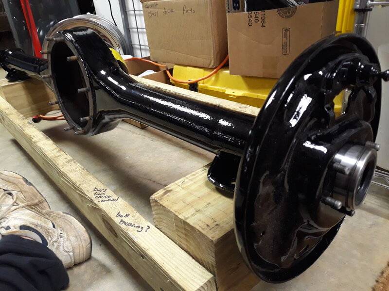

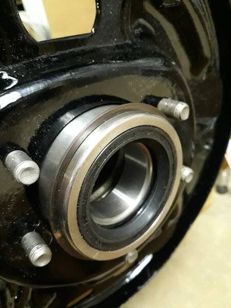

So in the picture, the retainer ring on the the green bearing (opposite side if O ring of course) will sit against the brake back plate, correct?? Plate goes on axle housing first, then the axle with plate, green bearing, retainer ring will slide in.
Faciously speaking.....its not too late to re-install the origional Timken Tapered axle bearings with the factory end play adjusters. All of your fitmet issues will go away, just follow the FSM procedures for installation and adjustment and you'll go down the road for miles and miles with out any reservations. Just return the Green bearings to the place of purchase for credit. Others will likely have a different opinion. Just my opinion of course.So in the picture, the retainer ring on the the green bearing (opposite side if O ring of course) will sit against the brake back plate, correct?? Plate goes on axle housing first, then the axle with plate, green bearing, retainer ring will slide in.
In this scenario the retainer/snap ring will sit against the outside of the brake plate. I'm currently installing green bearings on my 8 3/4 rear. It just dosen't seem right. It appears that a portion the outer race (comparatively speaking) is sitting "outside" the axle.

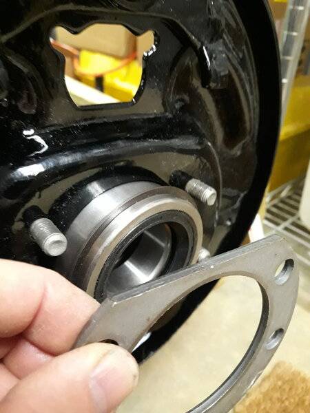

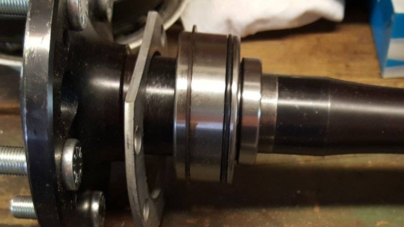

I've included pictures, with the bearings NOT pressed on yet because i wanted to make sure of how this would fit together. Just dosen't feel right!
View attachment 1041619 View attachment 1041620 View attachment 1041621
The ring plate you're holding in bottom pic goes btw the pressed axle end bearing and the end of axle. The outer protruding snap ring is to sit flush to this plate when you slide the axles in, if not, the thrust pin may need to be taken out; wasn't necessary with mine but some have said this needs doing if the axles don't fully seat. Back plate goes over this to torque nuts secure axle. That ring plate needs a gasketSo in the picture, the retainer ring on the the green bearing (opposite side if O ring of course) will sit against the brake back plate, correct?? Plate goes on axle housing first, then the axle with plate, green bearing, retainer ring will slide in.

Right, I was just holding everything up there for sequence visual. I was trying to visualize the setup before having the bearing and the collar pressed on. It just didn't seem right to pinch that snap ring on the bearing between the brake back plate and the 5 hole retaining plate. I have since had email contact with Dr. Diff. They said the heavy felt pad they provide is to go between the brake back plate and the 5 hole retaining plate. Otherwise the 5 hole retainer ring would bend over the snap ring.That green bearing with the nicely painted rear isn’t in the axle flange all the way. The bearing will stop on the backing plate at the snap ring.
It also appears when that (snap?) ring bottoms out against the brake plate a portion of the bearing race will be protruding beyond the axle body. That also bothered me but I guess the area protruding out has no load on it. The bearings are set more inside the axle tube. Just thinking out loud.That green bearing with the nicely painted rear isn’t in the axle flange all the way. The bearing will stop on the backing plate at the snap ring.
