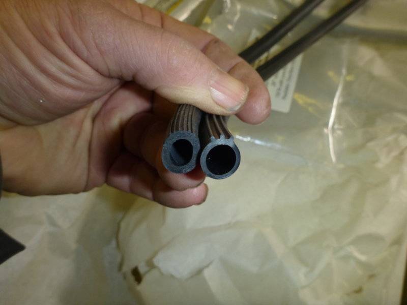

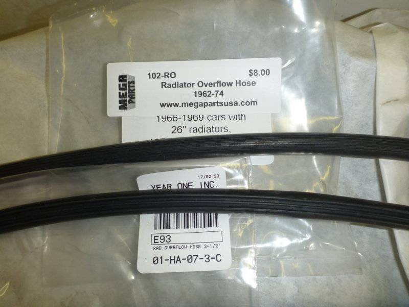

I posted this in my restoration thread, but thought I'd throw it out here as well so I can hopefully install tomorrow. I have both hoses.. actually have 2 of the lighter 3 rib.. so leaning towards the 3 rib hopefully being correct for my 22" x 1969 -053 radiator. Then I can use the 6 rib on my 26" radiator in the Bird.
Can someone tell me which is correct for the 22" radiator. The thicker, smaller height 6 rib or the lighter large height 3 rib. THANKS!

I have only seen the 6 rib version, no matter the radiator.
(Edit)ICCA book only shows pictures of the 6 rib also.
Mancini sells three kits, but their pictures are so small you can see anything. They sell the 26" x 6 rib hose I have for '66 to '69. A hose spec'd for 19 and 22" rads and a hose for '70 up rads... so there must be some original OE difference.
I got the Year One kits about 2 years ago that came with the 3 rib. Just bought the 6 rib from Jamie... and it appears to be the same as Mancini's for 26" rads.

Btw both hoses are not OE correct....the original hose is thin walled....I can take a pic of mine later.....if you want to see an original....
Most reading this will say the correct ribs is all you need.....sure for the novices but at a real judged event you may get dinged for the thick reproduction hose....
Justin I figured neither was truly OE correct. The 3 rib hose is a lot thinner than the 6 rib that Jamie sold me. I bought the 3 rib from YOne a couple of years ago and the 6 rib from Jamie this week. I figure if there are 3 hoses spelled out for different years and rad widths that maybe the lighter 3 rib was what 22" rads came with in '69. I only noticed Mancini's offerings last night. Is yours a 22 or 26" rad in the GTX? And yes.. I like pictures.. LOL
Maybe it's my eyes, but the 2 hoses side by side appear to have a different sized I.D. You might want to check the O.D. of the hose barb on the radiator to see which hose is more accurate.
They both fit snug on the hose barb, the 6 rib takes a bit more effort to get on. Just want to make sure I have something at least close to correct "profile" for a 22" radiator before I install, even if I have to buy another piece from someone else to get it right. I have shelves of incorrect repop stuff already, so no big deal if I get stuck with 30 bucks worth of hose.
The reason for three different part numbers is three different styles of radiator for the major years:
1. All 1966 - 1969 with 26" Radiator & 1974 with Overflow Tank
2. All 1962 - 1969 with 19" or 22" Radiator
3. All 1970 - 1973 with 22" or 26" Radiator
All three kits contain a 3 foot section of the six ribbed hose, so your able to trim as necessary. The hose is bought smooth and a machine cuts the grooves into the hose.
As Justin pointed out, the original hose is a thin wall design which we are not able to source through Gates or Goodyear. The thin wall design is pretty much history in the automotive industry as it will collapse on itself with the slightest vacuum pull. For the purist and the OE level of judging, then your limited to finding some good used hose.

I have to recant my statement on 6 rib from earlier. I am glad it is my memory that is getting shorter. My 3 original sample hoses for my 69's are all 3 rib thin wall, but with the small profile ribs. Also in the box is the new one for my current car with the clamps on it and it is thin wall 3 rib. I thought I may have purchased it from Quirey but my shopping list does not show who I bought it from. His catalog does show 2 different part numbers for 26" and one for 22"&19". Still, $8.35 is cheap enough and he is friendly and helpful, a rarity. Have him include a catalog, it is very specialized and you should be impressed. He was fast and sent me some modified hose needs.

Great info guys. Thanks for the incoming picture Justin! So some guys have found OE 3 rib and others 6 rib, but the Year One hose is definitely wrong by the sounds of it.
Rib markings are pretty much like bolt heading markings. Manufactures back in the day used the ribs to identify themselves to the manufactures. I would not say that 3, 5 or 6 ribs would be incorrect as manufactures used several vendors to stock the production line. Different production plant may have a preferred vendor due to location and thus the reason that you will see variations in models from the same body style and year model. The issue is how correct is the ribbing. Most of the original ribbing was cut into the hose, not molded into the piece.
