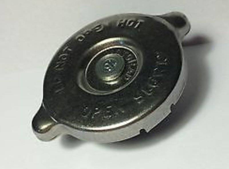

Currently have an old lever style 14lb radiator cap....would like to replace with new....for a 69 RR, 383 motor....what is the correct cap to use?
Not into original stuff, just want best one for the car....

These are what I use on all our "elderly" cars. I like the lever.
Rock Auto:
STANT 10331 {#11331, 861854} Safety Release Radiator Cap; Safety Release Vented Cap (Open or Closed System) - 16 psi (SAE Range 14-18 psi) Info Pressure Rating 16 psi
If you don't like the lever:
STANT 10231 {Click Info Button for Alternate/OEM Part Numbers} OE Type; Standard Vented Cap (Open or Closed System) - 16 psi (SAE Range 14-18 psi) Info Pressure Rating 16 psi
I do like the lever style, just wanted to be sure whats best for the motor.....no current cooling issues...and wasnt sure the correct lbs...is it suppose to be vented or closed?
Thanks
16lb 2 eared cap works for my 440. It's the one I remember from back in the day. Nothing screams aftermarket like the lever.
Looks like its going to be 16lb.....thanks!
