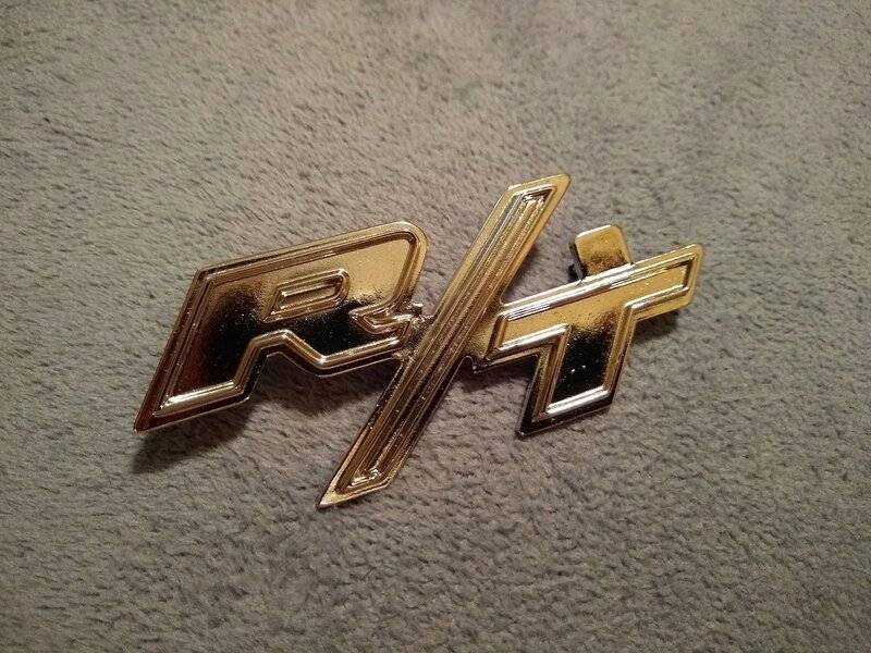

hello all.
I’m working on a 68 coronet RT tail panel. It was in super shape except the paint was chalky and worn.
I’m looking for the correct red color and sheen that was painted in the “R” and “T” in the emblem.
I’m considering making a custom blend with some thinned Testors model paint and shooting it with my air brush.
I just need to know if it was gloss or satin and if anyone knows a good match in a product line.
Thanks,
Rob

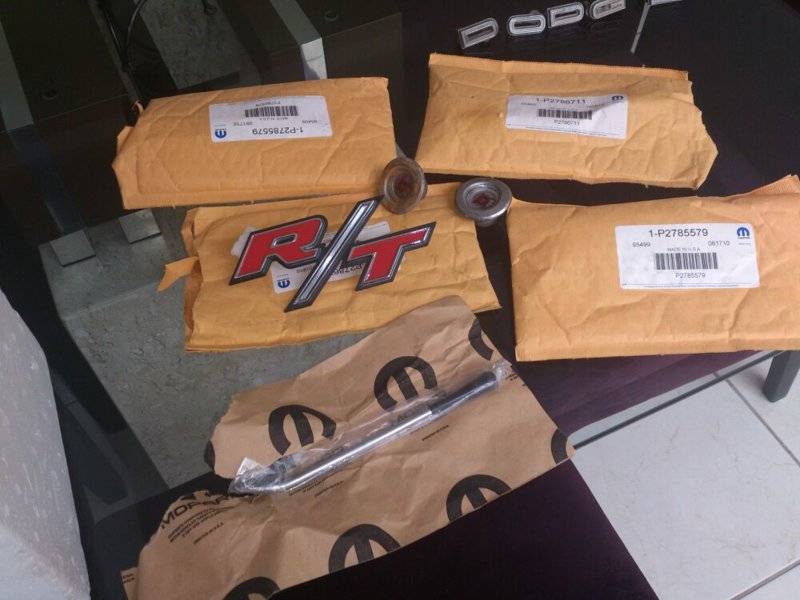

I buy my repro from my local dealer and Justin is right again ( what a surprise):lol: looks semi gloss to me.

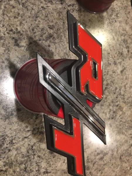

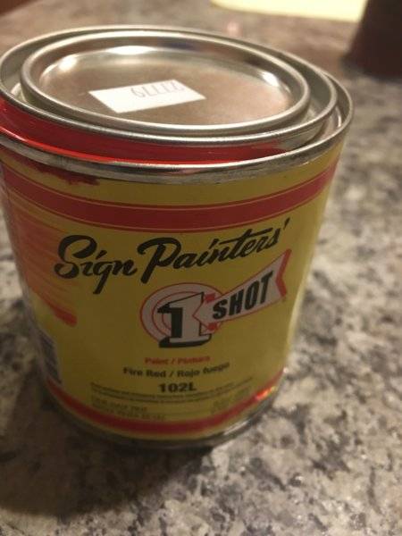

A turkey blaster is a bit large, not going to work well. Small dropper will do, that’s how I did mine. One shot sign paint.
Totally Auto tail panel red is what I use.

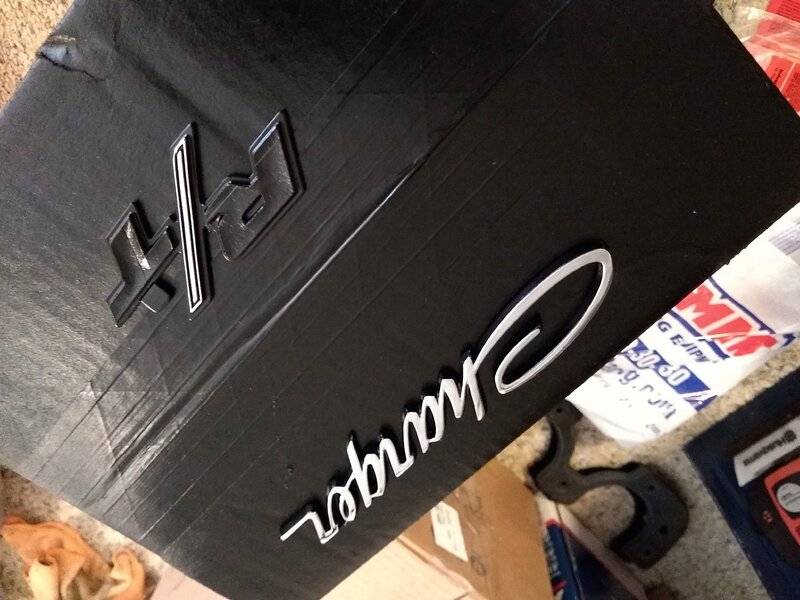

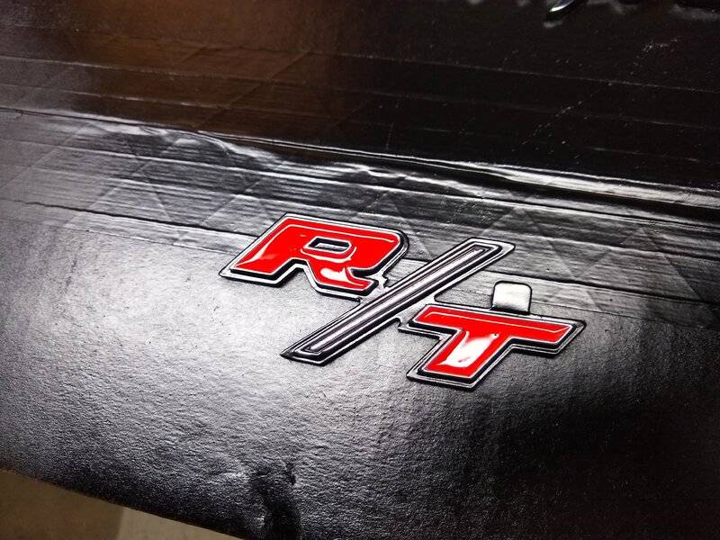

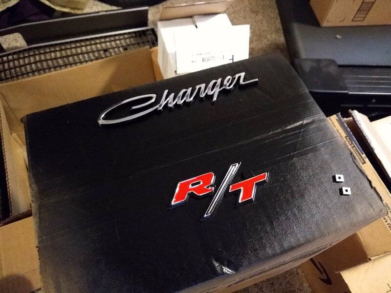

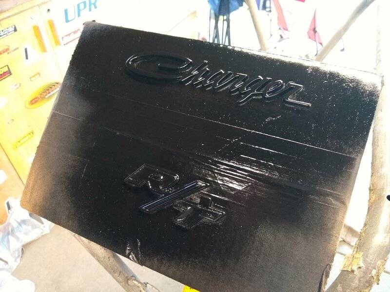

I just stripped and repainted my new grill emblems for my 68 Charger. They looked hand painted and uneven and the black on the emblems was shiny instead of satin. I soaked the emblems in thinner, masked off the RT and then sprayed both emblems with semi gloss black. I wiped the faces of the emblems with thinner to expose the chrome Then I ran up to Auto Zone and bought a jar of auto touch up paint, the kind with the brush and ball point tip. I chose a newer Corvette red and used the brush. I just blobbed the paint in to each letter and let it flow around the letters. I think they turned out well
Those turned out real nice.
