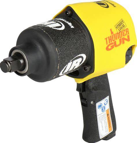

I have a gun identical to this...
And I squeeze the trigger until it stops. I have never had a broken stud or a stretched stud.
Never had one come loose either, which is a real disaster.
I have the predecessor to that gun (same model number but without TGSL).
It is adjustable to set a torque value at max PSI, and can be set different for fwd and rev.
Kind of a fiddly process but it works.
I have mine at max for lefty and about 80 at righty.
