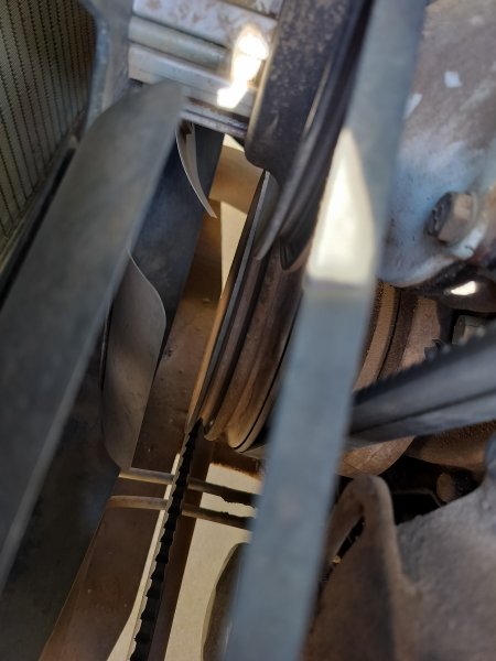

I'm currently under the vehicle. The crankshaft dampener has several timing marks on it—how can I identify which one is the top dead center (TDC) mark?
We had trouble confirming compression at the cylinder, so we used the pencil method to find TDC. The pencil did move, indicating piston travel. While under the car, I noticed two timing marks already visible on the dampener, and a third one is approaching the timing tab
My crank wheel has the extra marks. Number 1 is a larger mark, and goes right across the wheel. The other marks go half way across, and are 90 degrees apart. I made a mark on the engine, that I line up the other marls with.
