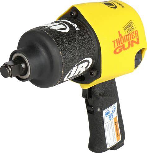

I have a gun identical to this...
And I squeeze the trigger until it stops. I have never had a broken stud or a stretched stud.
Never had one come loose either, which is a real disaster.
