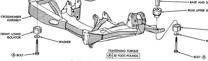

I just replaced the rubber isolators on the front crossmember of my 73 RoadRunner, the manual has 2 different torque specs for the bolts. On the diagram is has 50 Ft-Lb and in the step by step instructions it has 80 Ft-Lb. What would be correct?

Just replaced the same on my 73 charger. I went with 50 ft lbs. Will have to check with PST if they have torque specs recommended for their product
I did 80 on my 73, because I found at 50, I kept having to retorque, but also not using rubber but using urethane bushings.

Here is the latest update on this.
I contacted Energy Suspension and put this question to them. They do not have a tightening spec but said there should be no difference from the factory spec. Since the factory spec has 2 spec's published I went by bolt size. I measured the bolt at .557" and a pitch of 11 and a grade 5. On my chart the closes would be a 9/16-12 which has a torque of 82 ft lbs.
So I am going with 80 ft-lbs.
Thanks for all the input, it was very helpful.
