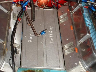

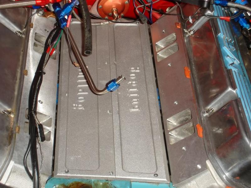

My 440 has the old bulldog two piece valley plate that looks like this.
I can't seem to be able to locate where I put the bolts... So I went to order some, of course ARP run 30-40bucks for a set of 6 and I need 8... I take it they get pretty warm and I shouldn't use ones I grab down at the hardware store? Hate to buy two sets.
