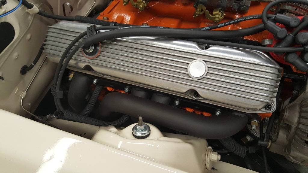

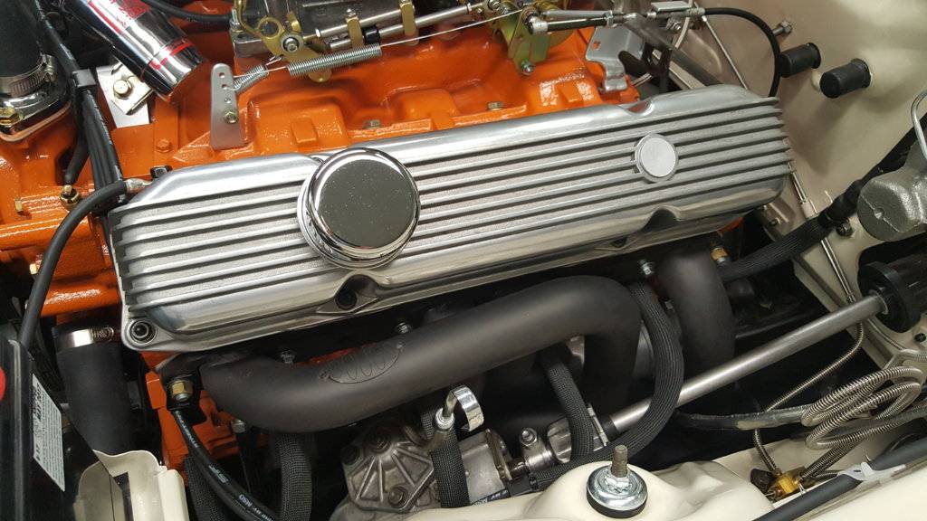

Have the TTI 1-7/8 on the 440 stroker in the Coronet Convertible. They fit good, but are not cheap. The vehicle is a crusier, not a race car and I just wanted something that fit well and was low hassle (no exhaust leaks.) No complaints on the TTI headers.

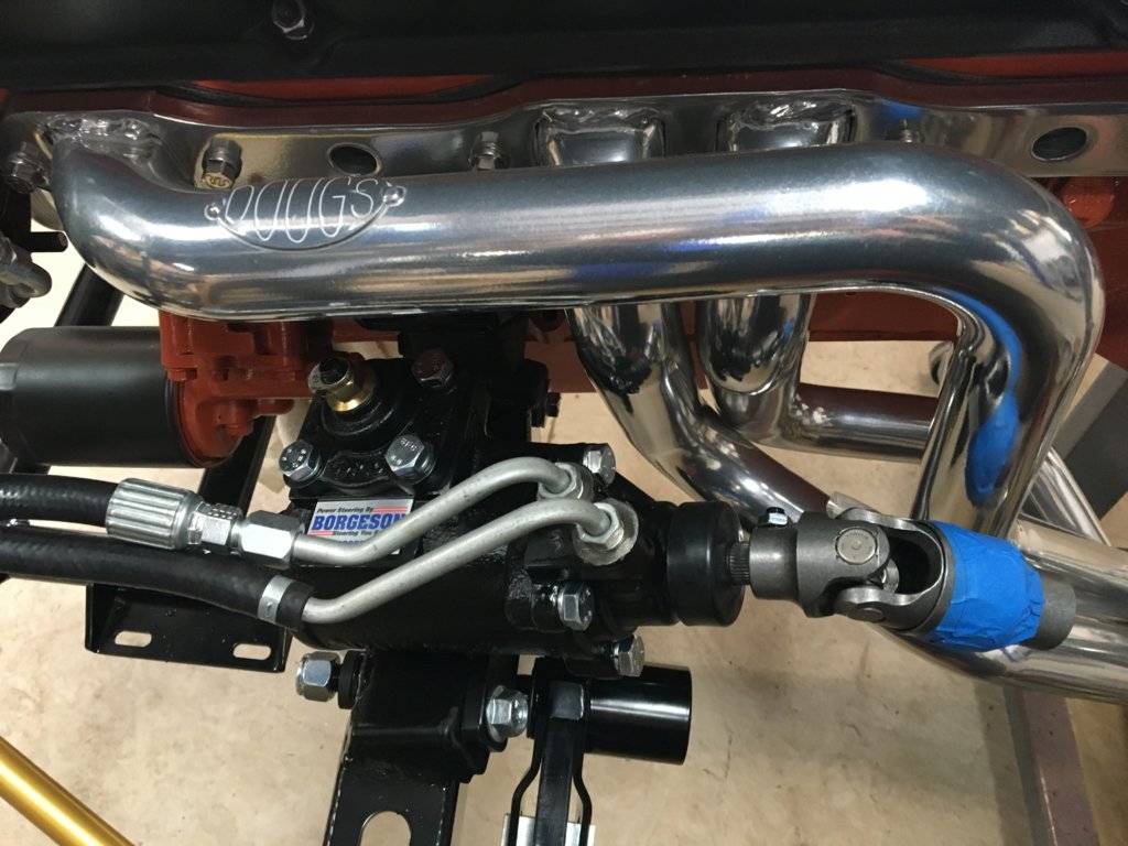

I bought the Doug's, 2" being on a tighter budget, I'm definitely pleased with them. They stated that the black painted ones won't burn off. They were right, even through the 20 min cam break-in, the black held up. Seems to even be stronger now that they've been heat cycled a couple of times. The clearance around the frame, steering, starter, is great. No hammers were used during the installation.

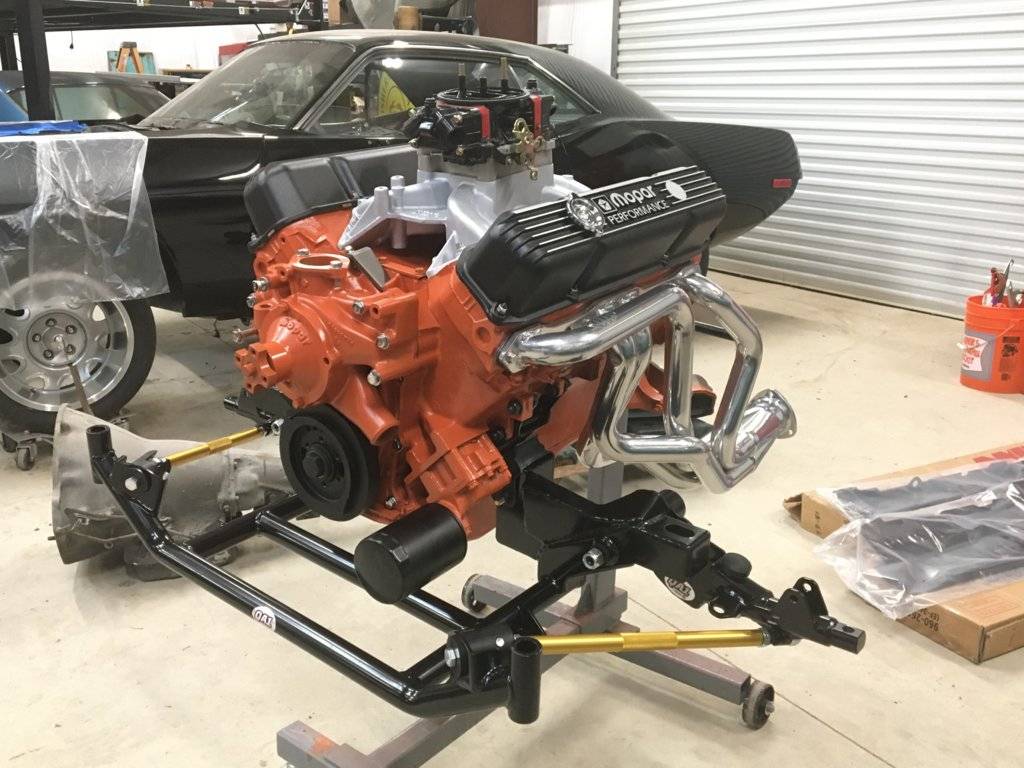

Dougs d451 or d452 depending on b or rb block on every mopar e or b body that I put headers on. Never looked back. Fit like a glove everytime.

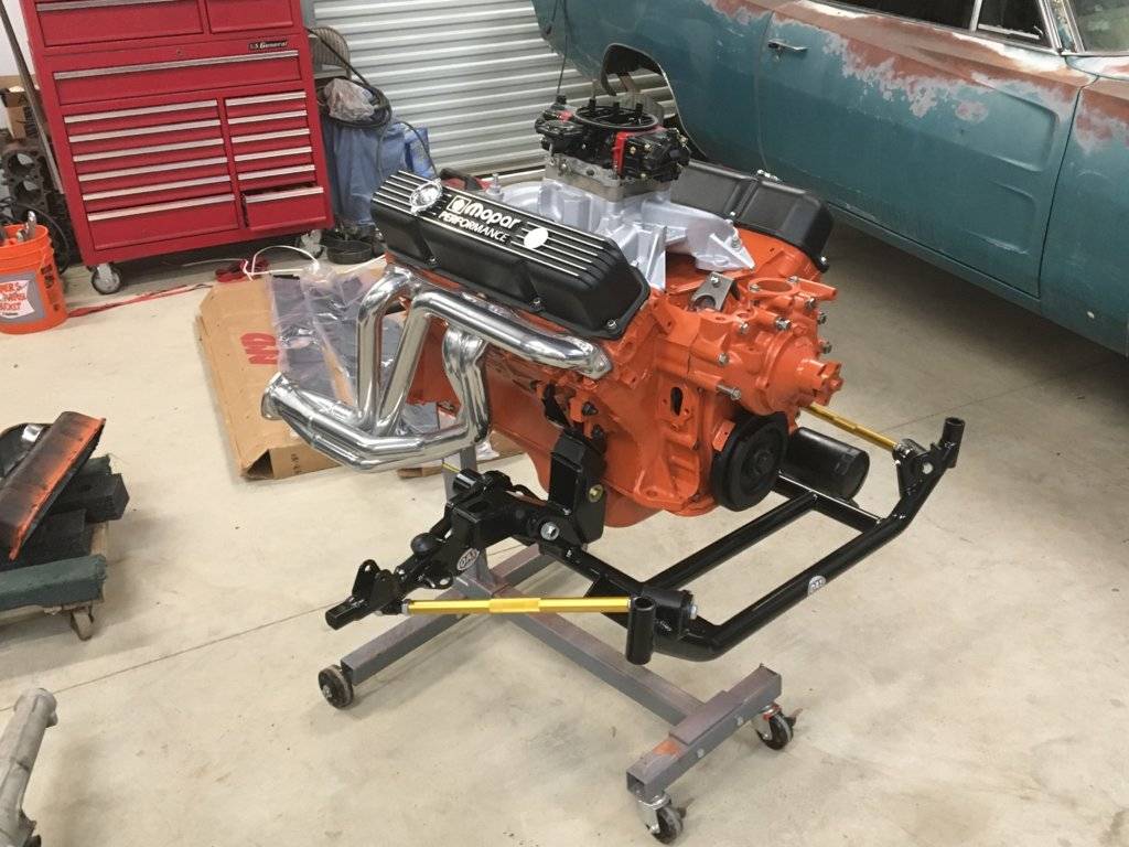

Get your wallet. TTI's were 1k to the door. Just the headers. Been on about 10 years. One ding required near the passenger side pitman.

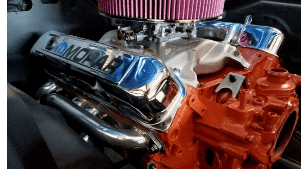

If your budget can't do dougs or tti, my vote is for Flowtech. I'm running their 1-3/4" ceramic coated headers - 451 in my 69 belvedere with stealth heads.
Nice ceramic coat look like chrome... fit is really good. like $350.
Took them off for the break in because of the ceramic coat, but I'll put the back in soon enough.
