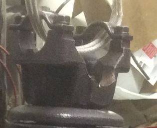

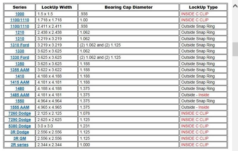

Here's a chart, note the width measurements on 7260 and 7290 are snap ring to snap so measurements will be short. The picture is a 66/67 1330 u-joint yoke, note the small tabs below cable. Don't think yours is this. Those tabs center the u-joint in the yoke.
Here's a chart, note the width measurements on 7260 and 7290 are snap ring to snap so measurements will be short. The picture is a 66/67 1330 u-joint yoke, note the small tabs below cable. Don't think yours is this. Those tabs center the u-joint in the yoke.View attachment 873338 View attachment 873339
Thank you, Fran. You’re a good man. That’s a nice chart. I also asked Napa to look at 7290 for shits and giggles. As I thought it would be, entirely too large. What doesn’t make sense, I most definitely have a 741 case, with a 2-1/8” yoke. I measured the inside of rear yoke. That definitely calls for a 7260 u joint. U-joint inside yoke is a good 2-3 millimeters too small inside rear yoke. I removed it there a few times to verify clips being installed correctly.
