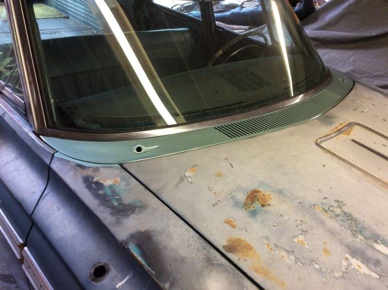

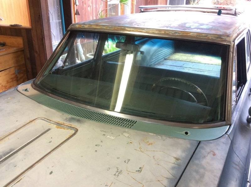

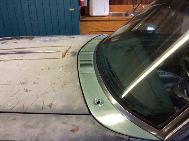

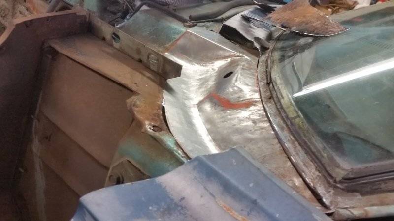

all done and trim + new windshield fits ! the finishing body work is not perfect but pretty close, and will fix when I do rest of body and paint
Looking great nice work in a short time. Waiting to see the rest.

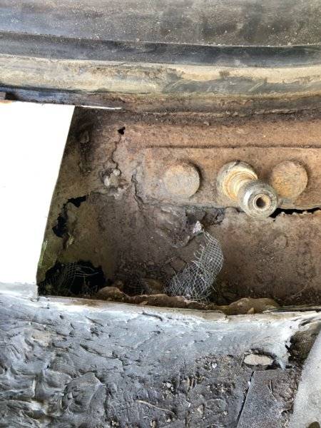

Thanks Evan! Started cutting into mine, and had to get under the gasket. Cuts we made so I definitely need a new one!

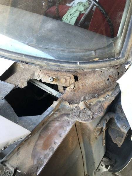

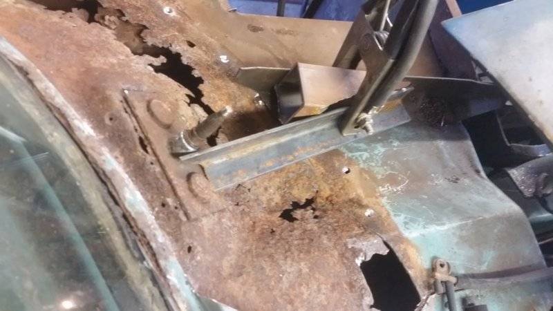

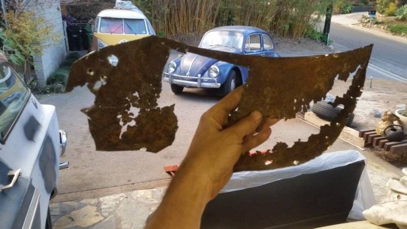

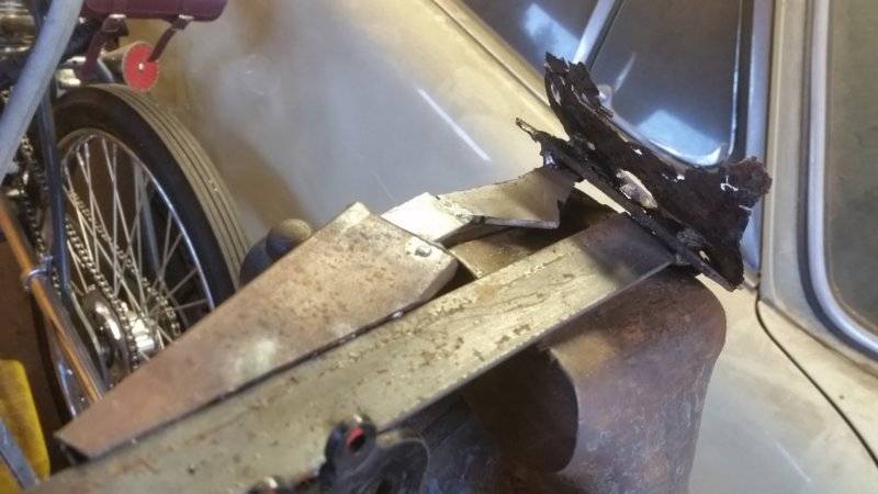

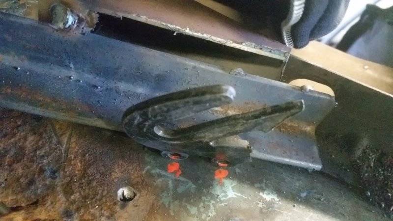

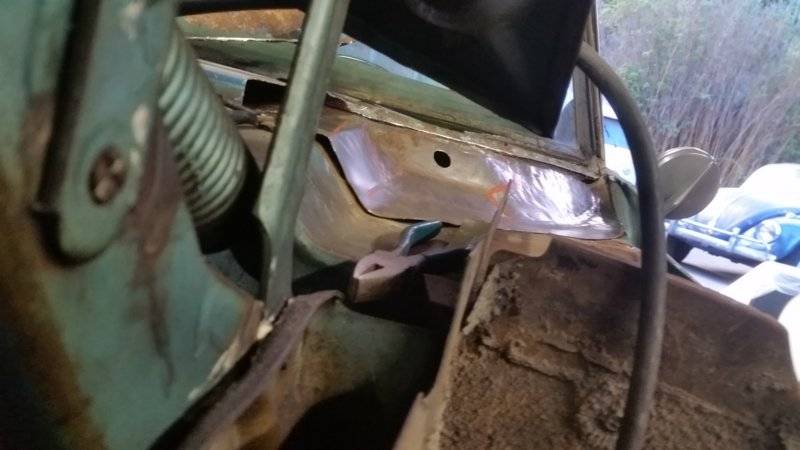

began the dreaded task of replacing the rusted out portions of the cowl today. damage is localized underneath and around the wiper pivot area on each side, which is apparently very common issue on 1962-65 cars. The driver side interior (lower) cowl panel collected debris and there is no drain on that side (known flaw in early mopars) The rest of the body is rust free except parts of the floor pan because of this same issue, water leaking through the holes in the cowl.
I'm going to incorporate a new design into the driver side cowl so that whatever gets in there will be able to drain. So that it won't rust out again.
I will shape the panels for this repair form scratch: using hammers, dollys, wooden blocks, sand bags, and whatever other hand tools I can find. I have limited resources. I'm using 20 gage sheet steel. Cutting with snips and cutoff wheel on air tool. Also have a dremel with mini cut off wheels and carbide bits to get into tight spots (very helpful.) + Mig welder to finish it off.
Thanks for viewing, hope this helps encourage people to tackle this stuff,...and I'm still learning BTW so call me out if I'm butchering it!

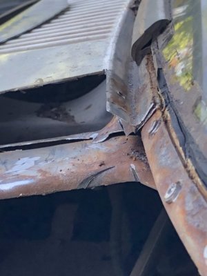

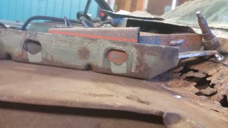

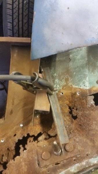

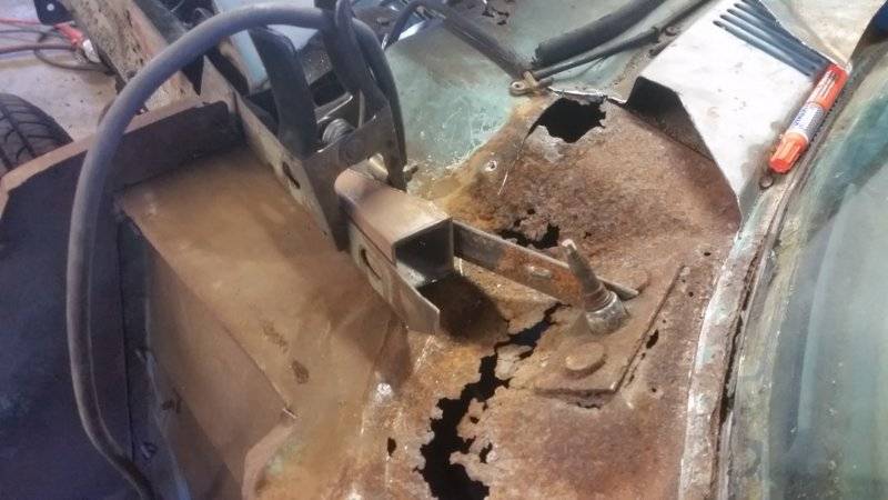

pictures showing a rigged up armature I came up with to help me make sure the wiper pivot bracket gets welded in the exact same spot as original. this is what I've done so far. going to continue work tmrw and post more progress.

Thanks everyone! this car has been on the backburner for a while. I've been driving this rat rod of sorts around town till just recently. It started having some sort of very annoying electrical problems (distributor, or coil or something???) a couple months ago that caused me to break down a few times... and I've been so busy building a 2180cc for my VW Beetle that I had to just put the Fury on the backburner for now.
Anyways, the repair has been holding up great and, no more leaky leaky, lol. I plan to really tackle the rest of the cars' gremlins once I get by Bug engine sorted. By this summer, I hope to start documenting the full body work, paint, interior, etc --- "build" in a similar thread... a garage resto of sorts.
