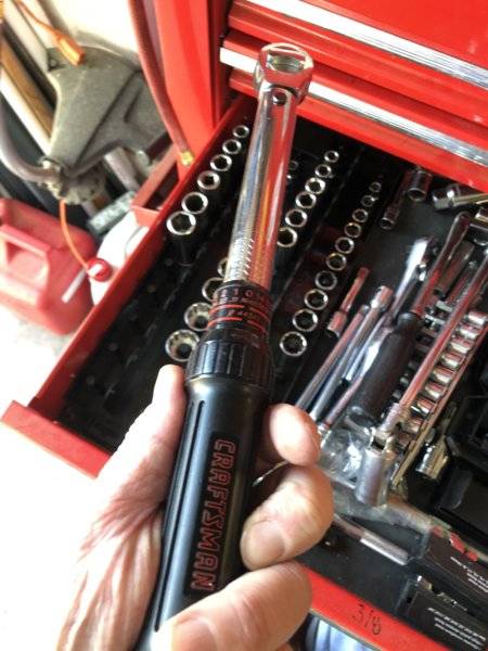

So I have a Craftsman torque wrench that is not working correctly. Does Craftsman still exist? Are torque wrenches covered with lifetime warranty?

Good question actually. It won’t lock on its set point. It’s plastic junk.
Good answer actually. Thanks. Toss that ******.
