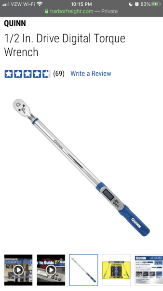

These look pretty good
https://www.harborfreight.com/hand-.../12-in-drive-digital-torque-wrench-64916.html
3% accuracy Mac does not even list their spec on their website.....

Their website sucks. We complained to them about it years ago. Most all torque wrenches are accurate to within 2%. I have a local company that repairs wrenches and precision measuring instruments that can calibrate and certify to within 1% or less. Most of the work they do is for John Deere. @HALIFAXHOPS calibrated torque wrenches when he was in the military and he is quite knowledgeable on the subject.
1% at 100 ft.lb. is only 1 ft.lb. The user is more inaccurate than that by pulling on the wrench after it clicks. Even torque between the fasteners is more important than being accurite to within 1% for most that we do.
