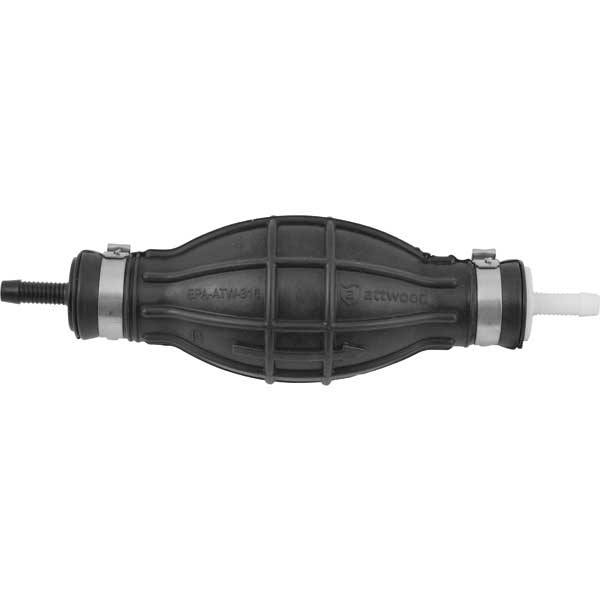

My other cars I install boat tank hand pump bulbs on the suction side of the mechanical pump. Works like a charm for cars that have been sitting up for a while or victims of heat soak.
Well, I took the advice above and went this route. Picked up a couple marine primer bulbs from my local West Marine this morning & they work like a charm. Just give it a few squeezes, then pump the gas 3 or 4 times and it starts right up.

now you need to fish one of these bad boys through the firewall, right next to the E brake release :thumbsup:
