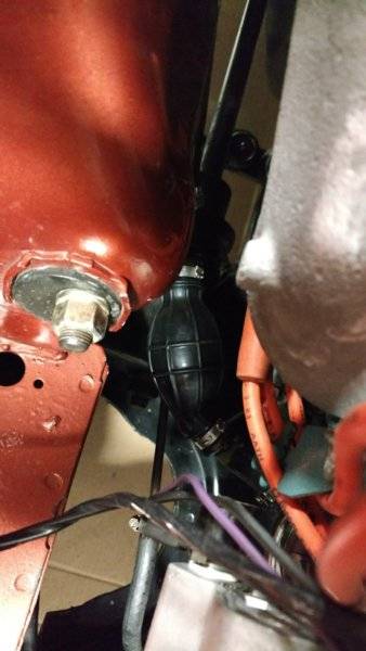

Any idea if that squeeze bulb will hold up to the heat? I'd be a little concerned.
Never had any problems with the heat. Been using them for years
