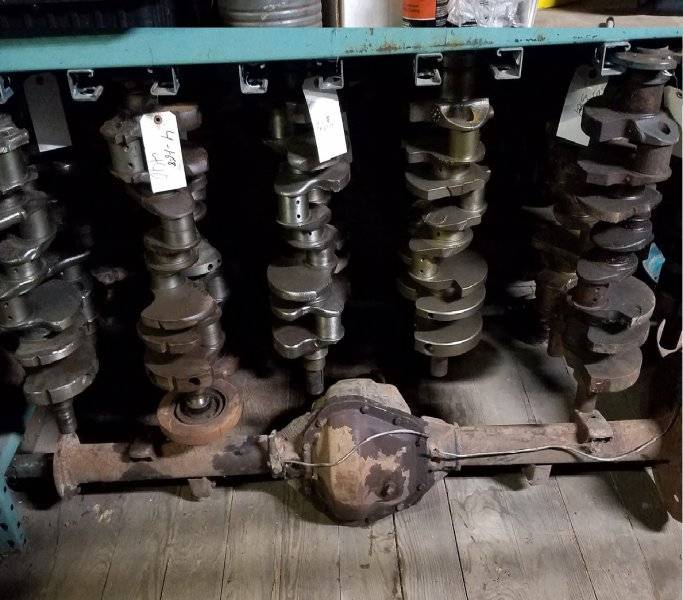

I used Uni-Strut to make rails for the cranks to hang from. I have used a few different ways to keep cranks from rusting.
I now have been using RP-342 you can buy on the internet by the can or case. cosmolinedirect.com or amazon Here are few methods some
from left to right.
1 Big Johnny's Crank Lube used to get it from Jefferson swap meet in the 90's I haven't seen it in years very much like RP-342
2 Biral spray grease messy and does not last long and expensive
3 Clear silicone spray preservative, used this until I found RP-342
4 RP-342
5 The front crank was greased in a bag when I got it. Was in a shed for years grease melted away. Grease is good for a few years only
then needs to be reapplied. The crank right behind that one has Goodson brand RS-16 on it. Seams like good stuff but I only ever had one
can of that stuff.
I also use RP-342 on flywheels and drums and rotors.
