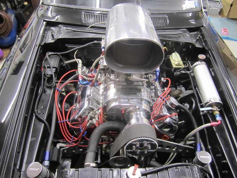

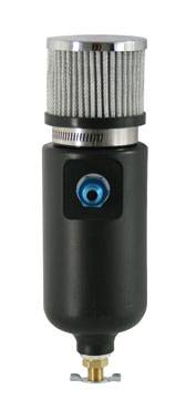

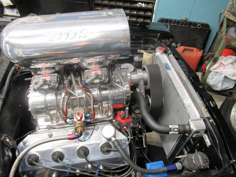

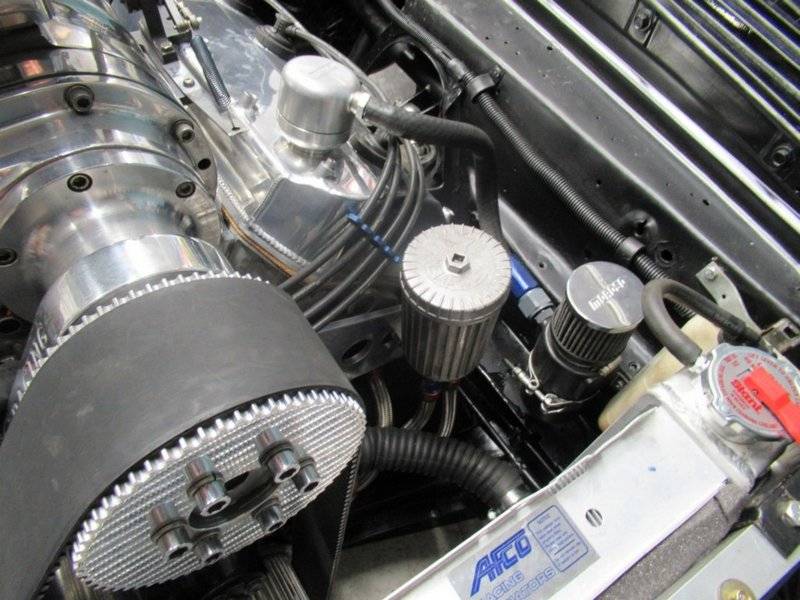

I push in breathers for many years with a pan evac system untill I started blowing the breathers off.I went to a moroso bolt in breather and 2 puke tanks.Works well,keeps any oil from entering the combustion chamber causing detonation

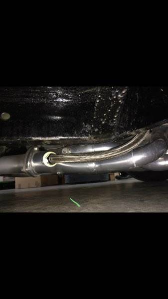

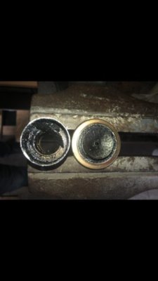

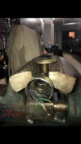

Yesterday I check deinstall my checkvalve on the collector tube and test it. The air flow in both way means the check valve not working well.
After I cut it apart I see the rubber flap full burned off.
Any idea to fix this problem before install new check valves ?
I had some old one and install it right now , but this time with a little bid Teflon around the thread before turn in on , for get the valves colder , don’t know it makes sense .

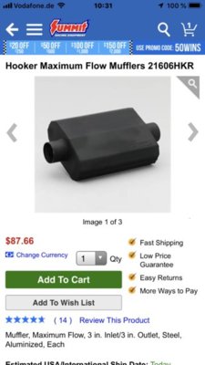

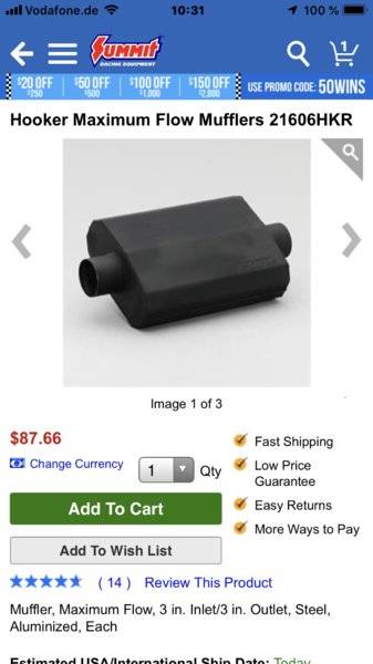

Anywhere , before I switch to something like breathers with catch can first I want try to install a other muffler ... now I drive the Flowmaster 50 and read in a other conversation somebody talk about some Hooker muffler they are non restrictive and best to use for geht less backflow.
I found these guys on summit , and he talk about this mufflers
More than likely your check valves are shot, and probably because the exhaust system is too restrictive. The header evacuation will work with full exhaust system to different degrees - depending on how restrictive the system is. The check valves will be the fail point. Key to prolonging their life is minimizing exhaust restriction. First order of business is never run any kind of baffled mufflers. Straight through glass packs only - if you have to run mufflers.

Yes, that’s the point . I think the Flowmaster 50 series are baffled mufflers . That’s the “ problem “ why the EVAC over the headers not work properly .... but I worry the hooker muffler very loud, and the police not like it

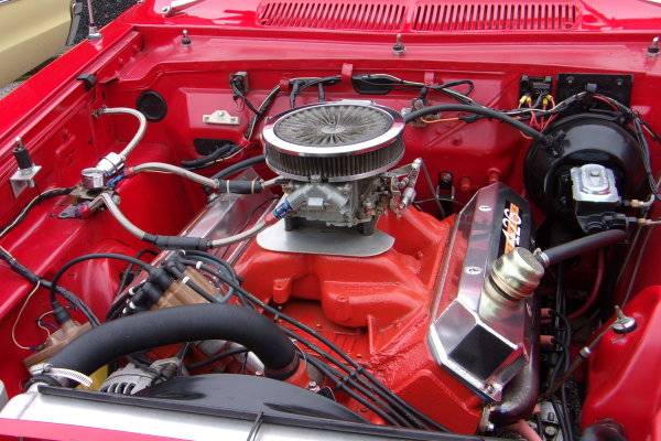

I can totally understand why you wont put the breather like I run in this pic on your Hemi.. No way would I butcher up Hemi valve covers to do that.
Course it works fine for my wedge with the valve covers I run. Myself I like having the PCV system on my eng but I did run it with just breathers for about a month when I first put the eng in the car. The hose on my drivers valve cover is all open as I just run it to the side of the eng. I did that because I thought it may spit some oil out the breather when racing onto my valve cover. But its never spit any oil. Running a breather on each valve cover worked ok but since I have enough vacuum for the PCV system I prefer to run the PCV since 99% of my driving is driving on the street. And I wanted to have the crankcase well ventilated so no moister would build un in the eng with the PCV system pulling any fumes and blowby out faster then just breathers will. Ron
