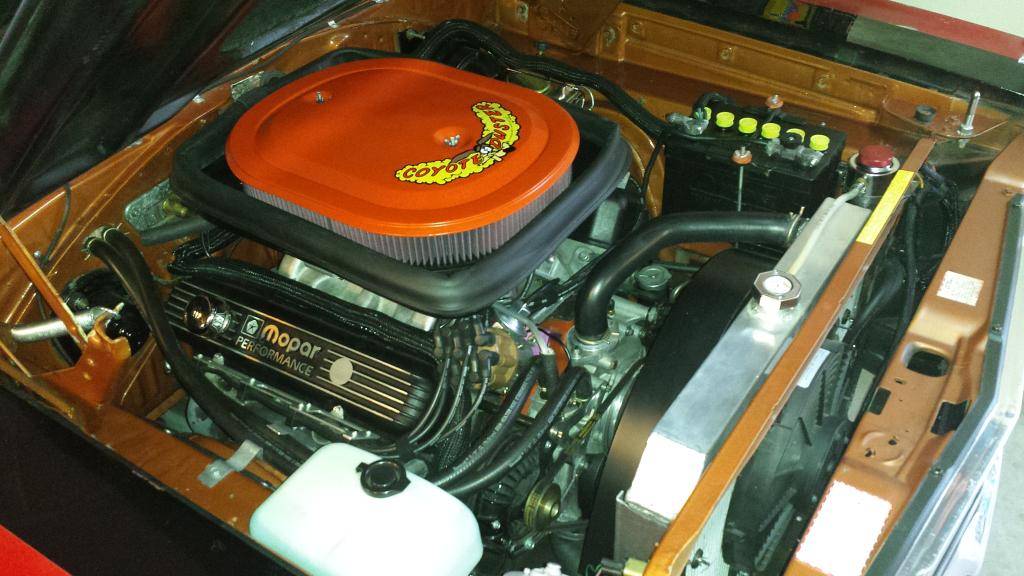

I'm going to use a pcv on one valve cover and plug on the other for inspections - then just go back to PCV + breather after inspection. Bigman - I love your engine bay. Really clean. I think I'm going to steal some ideas from you. :)
Help your self! :)
This is how I bought it.
