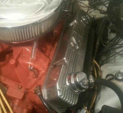

My 1969 440 has a PCV valve on pass side and a push in breather on the driver side. I have a aftermarket chrome air cleaner.
