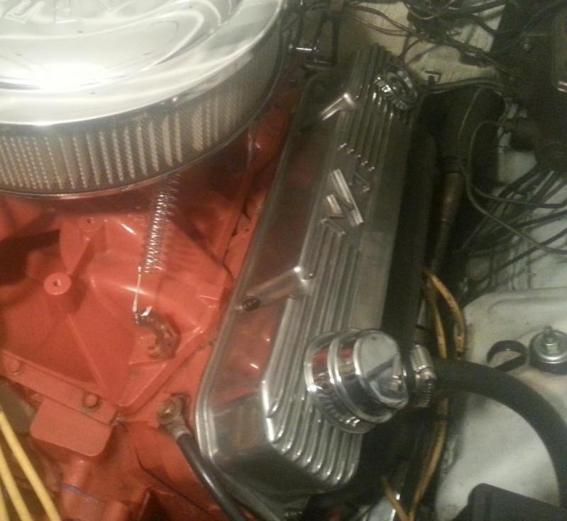

Not to jack Workinmans post, but I wanted to go in the other direction and see what you guys thought. I originally was driving the car to cruise nights and car shows. I have a pcv valve to the carb base and a breather on the other side. I started going to the track more often and think that more of my time will be spent there. I will however, still be driving on the street. On the street, even with some occasional "outbursts", the engine compartment has always been completely dry. When I go to the track, after my runs, I have always had an oil mist covering everything. Not a lot, but enough to burn off the headers and have the guy at the burnout box take a peek underneath. Never anything dripping. I don't know exactly where its coming from. Any ideas? should I run two breathers at the track? I heard that an scavenge system wouldn't work on the street.
sounds like you got a little too much blow-by past the rings
I was having the same exact problem at the track. On the passenger side valve cover I had a PCV on the back of the valve cover going into the carb base. On the driver's side I had one of those twist on breathers with the little vent holes in a ring along the bottom that served as a combo breather/oil fill cap that was also on the back side of the valve cover. Enough would mist out on the top end to get on the headers on make a cloud of smoke and get the track officials excited.
So what I did was drill a hole in the front of the driver's valve cover and put one of the Moroso Mopar-style breathers there and used the twist-on hole on the back of the valve cover for a proper oil fill cap. The breather has a rubber hose coming off it like you would run to a header bung, only I run it down to a catch can under the battery tray just in case it ever wants to spew but so far I don't think it has. I took it to the track last week and so far, so good, problem solved.
I think you maybe need to have the PCV kitty corner from the breather on the opposite side. So if the PCV is on the back of the passenger side, the breather should be on the front of the driver's side. Also, I think when I had the breather on the back, oil was sloshing back there on launch. Anyway, that's what worked for me.
