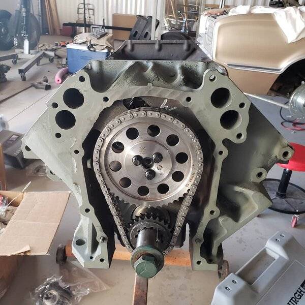

Here's the pic I took when I installed the cam.

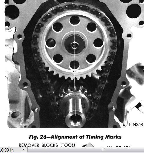

You’re 180 degrees out. When the dot on the cam gear is down and the dot on the crank gear is up is TDC for #6. You need to turn it over once so both dots are up for TDC on #1. Lots of people have blown up mufflers that way, myself included.

The pic is how I installed it. I cant remember if I put the timing cover on before I adjusted the rocker arms. Had to rotate the engine a few times plus while I was priming the oil pump. As for the solenoid on the firewall, yes it is. Forgot about that, will be easy to hook up a remote starter that way. Hopefully it's just as easy as that. Firing order has been more than triple verified, internet Google search, SM, and laminated chart. I'll post later on any progress.
Maybe don't get your description but think its wrong.
