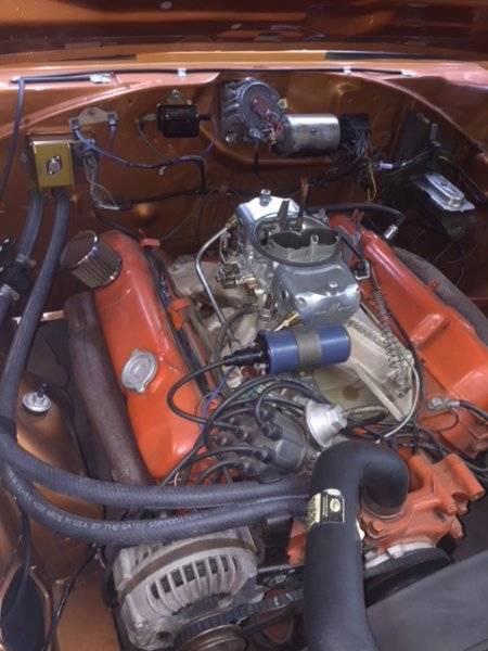

I dont get---- getting 400-450 hp out of a 383? It does have Edelbrock aluminum intake with 850 Demon carb.... illegedly rebuilt witha cam about 1000 miles ago, and i think its a pig.... mind you my last ride wax a 31 ford with a 383 stroker small block that FLEW
That 383 is a badass little engine, can rev up to 6500 RPM No Problem, can you tells us a little bit about your combo, like compression, heads, intake single or duel plane, carburetor, what ignition, cam specs, ECT
Unfortunately i have NO info on the motor, so maybe "dialing" it in is a good start point......

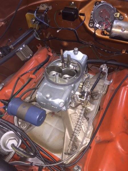

Personally I prefer a dual single plane manifold for a street car. looks like you have a Torker single plane manifold, a dual plane manifold like a Edelbrock performer RPM, or my all time favorite is the Indy dual plane manifold.
Edelbrock makes a Top End kit that they say makes 500 horsepower, it includes a New cam , New Heads, New Dual plane Performer RPM Manifold, and I think a timing chain, plus all the gaskets needed to make the change over. personally I would chase dyno your car Now before you make any changes, then dyno it again after you make all the changes, so you can see the deference in horse power, the best part is you can do all the up grades with out pulling the engine, (I'm telling you that 383 would scream!!) you mite need a new clutch at that point to so my be mite be better to pull the motor ? Plus a Full MSD Ignition

It's your car - but it sounds like the 383 has typical "rebuilt 383" problems and isn't anywhere near what you were told for power. If it were me I'd pull some stuff and see what you really have, and what quality the labor to put it together was. More than likely you have a 9:1 383 with a cam that's not degreed. At minimum...lol.
