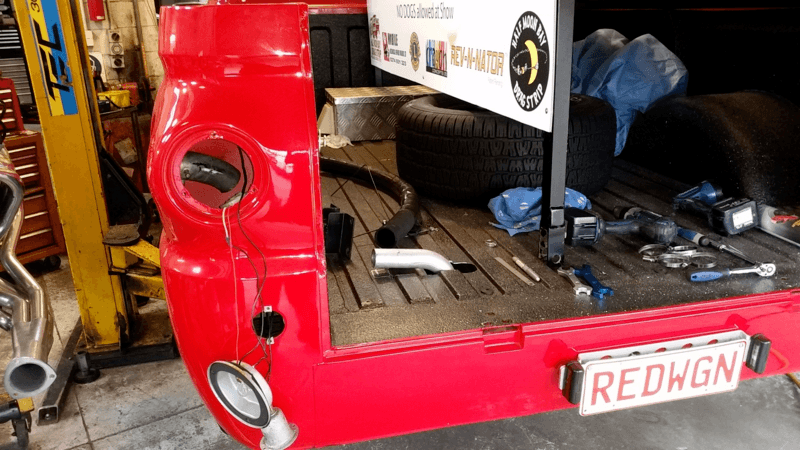

I need a hose from pop up neck to tank neck and it has to be bent specifically. Ideas?

Hmm. I guess I was not clear. I need something to connect filler to tank filler. 1 5/8ths ID. I guess I will have to use rubber and steel pieces to get the correct angles etc.

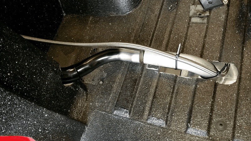

maybe I will slice a hole in the gas lift support base and weld a down tube right through it at the correct angle. The attach the top of the tube to the filler neck hanging down from next to the trunk lid and the bottom end to the fill neck on my tank. That will give me a custom look and a little flex at both ends.

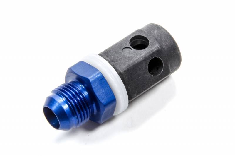

The 3/8ths fuel line I bought has this flared ends for hose connection. The tank has AN fittings. So I guess I will need the correct size -8 AN Fuel Pickup, Rollover Vent & Fuel Return fittings.
So, of the three -8AN fittings sticking up, which one is the roll over vent? Or are they all the same and it doesn't matter? Stupid questions, I know.

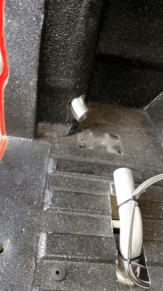

All one piece from filler neck flange to the entry tube for the tank.
44mm OD tubing, and 44mm ID flexible between filler pipe and tank neck - the gap ended up being approximately 1/4" (6mm) when fitted. Used double hoes clamps at 180 degrees on both sides of the joint. No leaky now, and an easy fast fill.

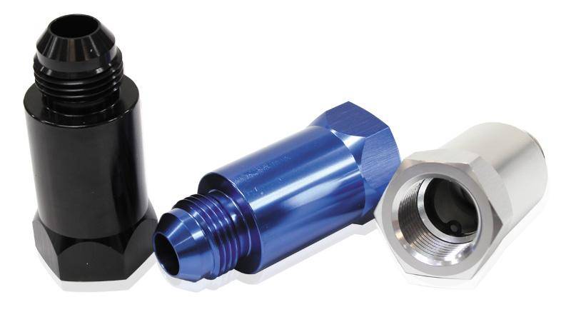

HI Ghost, the three AN- male fittings on your tank are outlet, return, vent. If you poke a screwdriver down the center of each fitting one of them should have a Ball bearing (check valve/roll over valve ) if not you can buy one that mounts to your trunk floor bulk head style , or one with a AN- Female to male end that will mate up with the existing tank fitting and then vent outside the trunk.
1,connects to tank fitting
2, bulkhead style to existing fitting in tank.
AN- hose fittings are easy to connect to steel braided line
