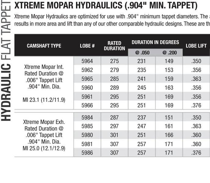

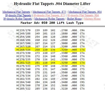

Here it is from Bullets lobe list. It's for 904 lifter. there is a H273 that can be used for intake lobes and it's asymmetrical for a gentler closing which is easier on valve train as OP requested

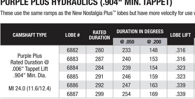

Here are some more mopar lobes, second one down is Howards .903 hft’s. The Bullet HFT is a couple post up in post 103, Bullet has some good .875” profiles too. They all have more .2” duration than what you see for a .842 lifter. A cam from Engle would be a contender also. The extra area under the curve for a bigger lifter profiles also tames the cam down a little compared to equal .050” specs for a .842” profile, and the mopar profile makes more power at the same time. Makes sense to use the mopar design attributes to our advantage.

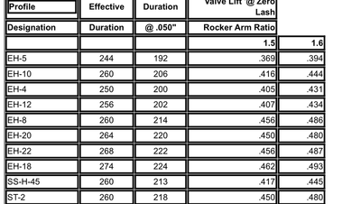

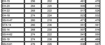

I notice Racer Brown has his EH20 listed with 1.7 rocker. Makes it look like a different animal. .509 lift.

Yep, same profile still a .3. I thought it was interesting he had it list for the 1.7 bbc and the 1.73 fords. Must be pretty gentle.
We used a 218/218 .445/.445 112 lsa in a 400, it had longer seat timings than that EH-20, more like factory mopar cams. Previous 400 in the car had a six pack cam we had from a factory six pack engine from our 70 Cuda. The 218/218 had a rougher idle than the six pack, six pack cam was noticeable more powerful on the top end.

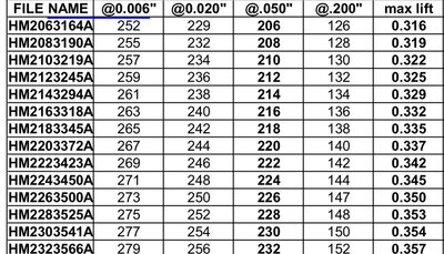

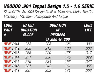

Thanks where did you find that Lunati information. Lunati Has not published a lobe list catalog in a long time
VH41-VH47 look like good lobes
you can compare BH43 with Mikes recommendation and see how much difference a MOPAR lobe makes
and compare with the other mopar lobe

Bullet 268 229 130 .326 aswymetrical

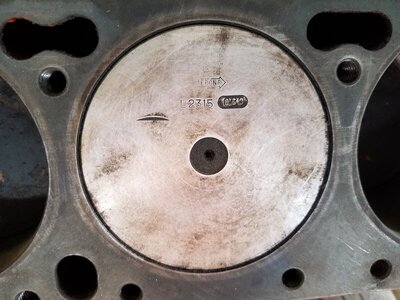

451Mopar, LOL, that looks like the valve to piston marks on one of our 383s. Ours happened somewhere around 6500-7000 with a MP484 cam.
