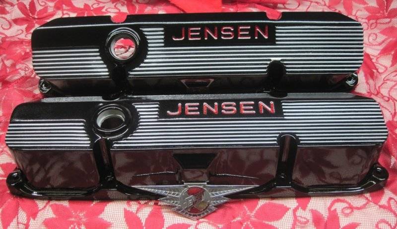

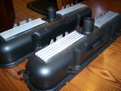

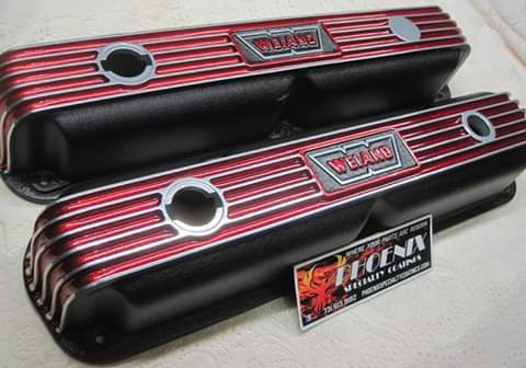

Yes, Leanna does a kick *** job duplicating factory wrinkle finish! Here's a little before and after.

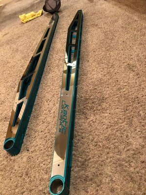

I have a few projects that I would like to try the powder chrome on.
I have been using a single stage the last few years that doesn't require a dulling clearcoat to retain UV stability. It looks better in my opinion in smaller doses (accent areas) than on full-body parts but is still better than other chrome replicas I have shot in the past. It was used on all of these parts.

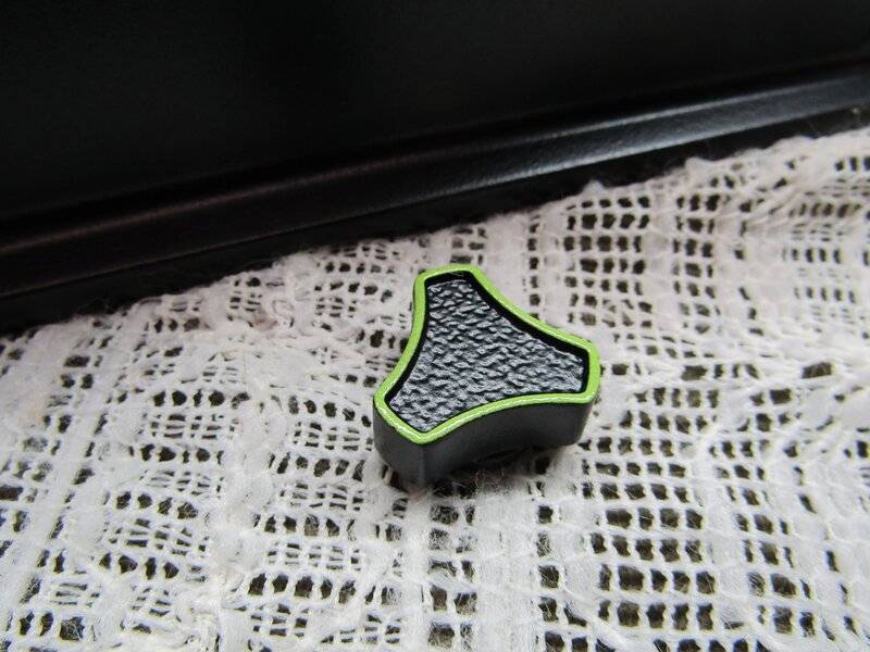

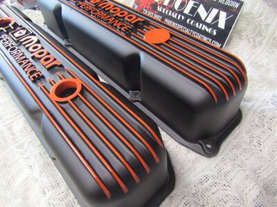

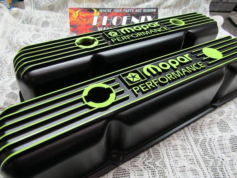

Some new Powder ****!
Although it seems most of the shows have been canceled or postponed, it's REALLY picking up the last couple of weeks with new parts arriving and lots of quote requests. It almost feels like the Fall Teardown Season instead of cruising time. Thank you ALL for helping me feel "essential." :carrot::D
imagejpeg_1(1).jpg IMG_3430.jpg EWvgQCJXgAYWH23.jpeg EWvgQBtWkAAU_Hb.jpeg ESckvoNXcAAYRKZ.jpeg ESckryeXQAImcNm.jpeg ESckryIXkAIetfS.jpeg

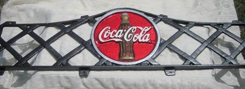

View attachment 930372 View attachment 930373 View attachment 930374 View attachment 930375 View attachment 930376
I would have enjoyed seeing the Coke owner's face when you first unveiled the refinished bench back. Wow!

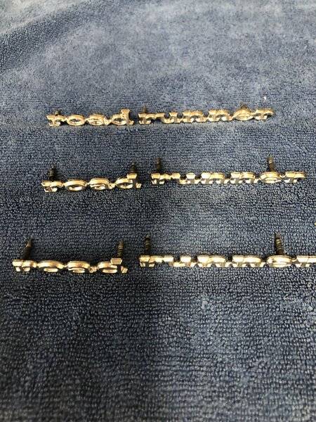

Can you powder coat the black shadow paint on my road runner emblems. I have the doors and the trunk lid 1969 road runner and want them to appear stock with a shiny finish on the face and black shadow paint or powder coat. I have already removed all the original black
If leanna doesn't do those, I just restored one. Clean it very well with a stiff bristle tooth brush. Clean off flakey paint with a brass brush. Clean with acetone. Mount it on a corrugated cardboard by pushing the pins through it. Paint with a good flat black rattle can...light coats. Wrap a shop towel tightly around your finger tip, damped with laquer thinner. Lightly -repeatedly wipe off the paint on the surface of the letters. move the shop towel often on your finger to keep off a build up of paint. I don't know how long it will last, but looks good.....................MO

I just had a message about emblems a couple days ago. This is what I told Nick. (His were black, red, white and blue so disregard the part about the multiple cure cycles.)
"Chances are good it's probably pot metal, though I'm not certain. I've done emblems in the past (with success) but there is always a chance excess air in the casting or impurities in the metal can make them blow up with bubbles when it's heated to cure the powder.
Generally, thinner pieces turn out better than thick ones (i.e. emblems vs. door handles or hood inserts) but it's still always a crap shoot from one to the next ... you just never know what pot metal is going to have in it since it's cast from all the steel plant leftovers on any given day. Pewter for example has a melt point of 140 degrees.
Consider too that it would need to go through four separate heat cycles, one for each color.
It's a decision only you can make. I won't try to talk you into it. Since you already had it replated especially, you've already "got skin in the game" ... and know better than me on market availability and rareness. If they're cheap and easy to find, that can be an easier decision to experiment on versus a one-year-only piece that cost $345.
I don't have any work sample emblems on my phone but there are quite a few on my website Gallery (in the Misc. Metals / Other Car Parts section) you can check out.
If you have questions or want to talk about details, just call me.

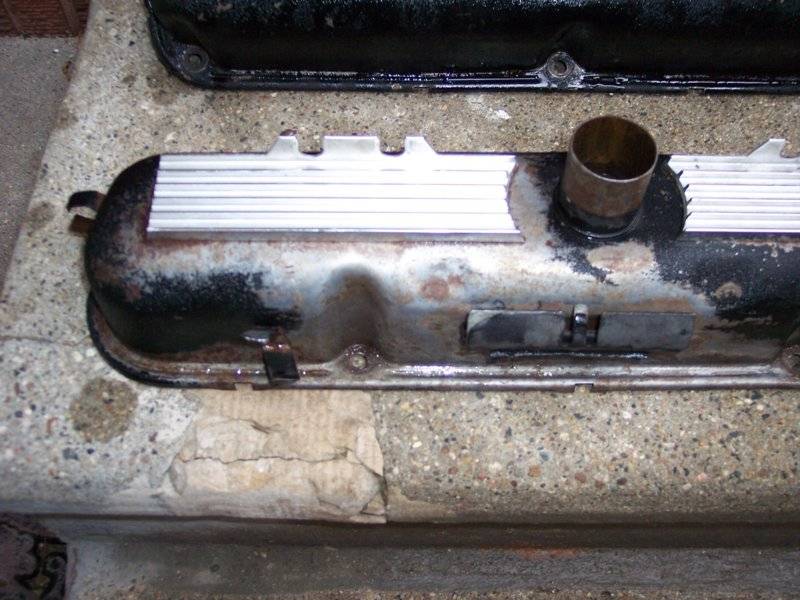

These were from a Dodge 800 a few years ago. The Before Picture is on the left.
