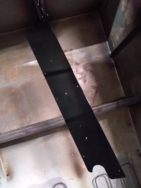

Here's some new Powder ****!

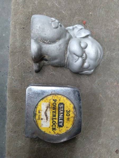

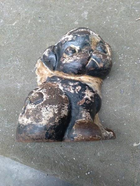

... and something completely different, an antique cast iron door stop named Pupp-O! He had a pretty "ruff" life.
Now restored in 6 colors, he should live for a few more generations.

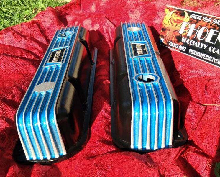

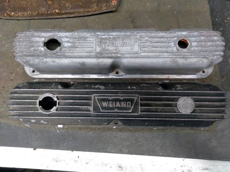

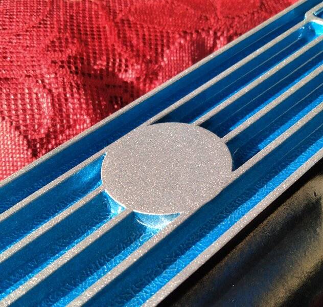

WOW .... just WOW!Today's Powder **** belongs to FABO/FBBO Member @Stephen Hotz!

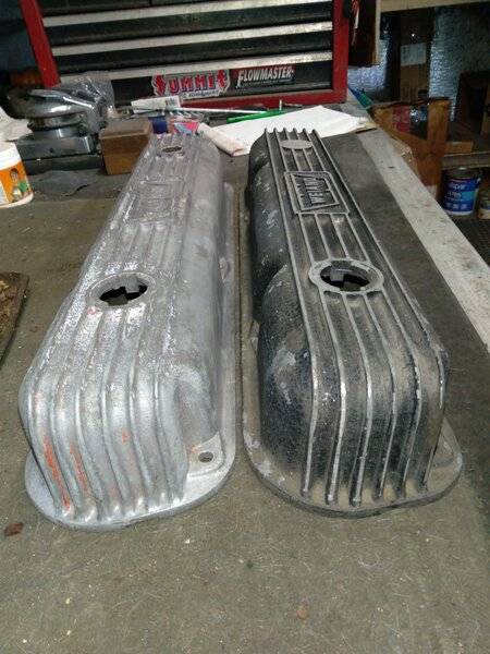

He entrusted me with a very decent pair of small block Weiand valve covers with NO parameters at all -- "Do whatever you want!" -- so I asked a few questions about the car and came up with something distinctive we can both be proud of.

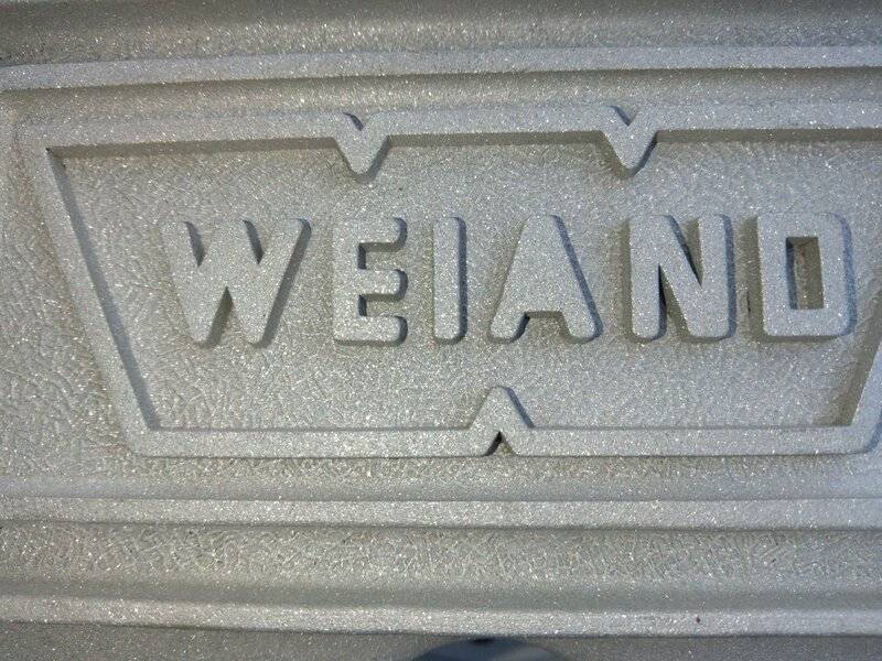

From arrival to Powder ****: One was bare and fairly oxidized but metal damage was very minimal.
One of the letters needed some attention, but that traditional Weiand texture was so primo on this set that I had to USE IT.

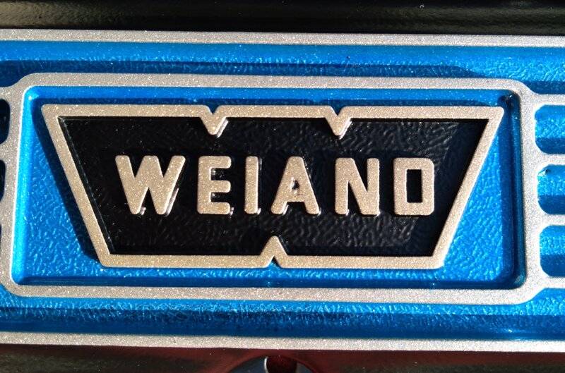

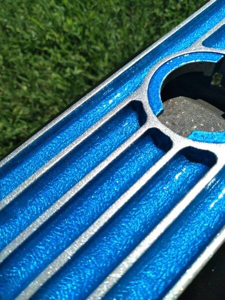

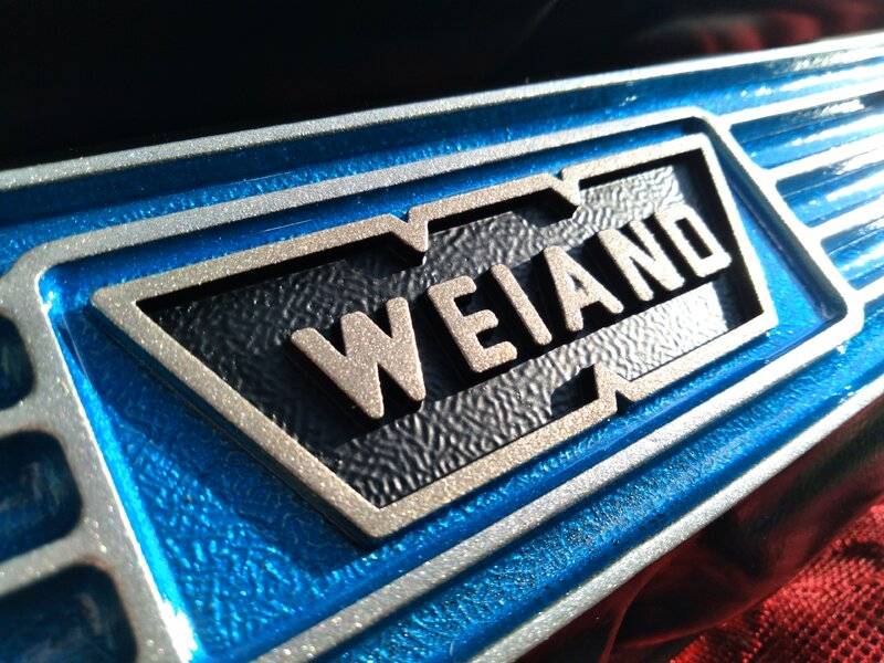

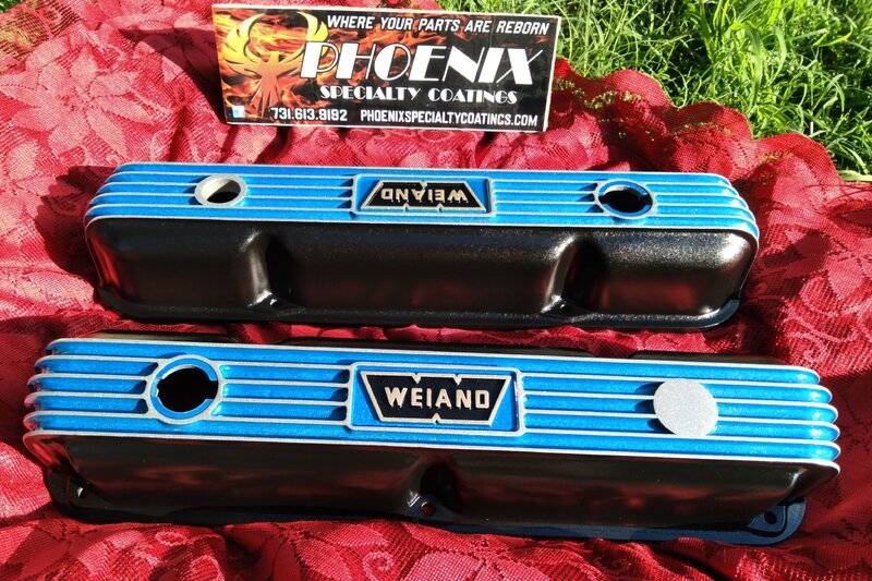

Here they are now! His Corporate Blue has been injected with steroids, the metallic silver will tie in with his intake, and the bodies were finished in the wrinkle black he mentioned liking.
Straight up as always, I nearly peed my pants when I dragged one out to the sunlight. That new candy blue is off the charts!
I went with an Old School treatment on the logos in metallic gold against flat black.
Stephen, thank you for the opportunity to work with you again! I'm delighted that you're happy with the result. I truly appreciate your business!

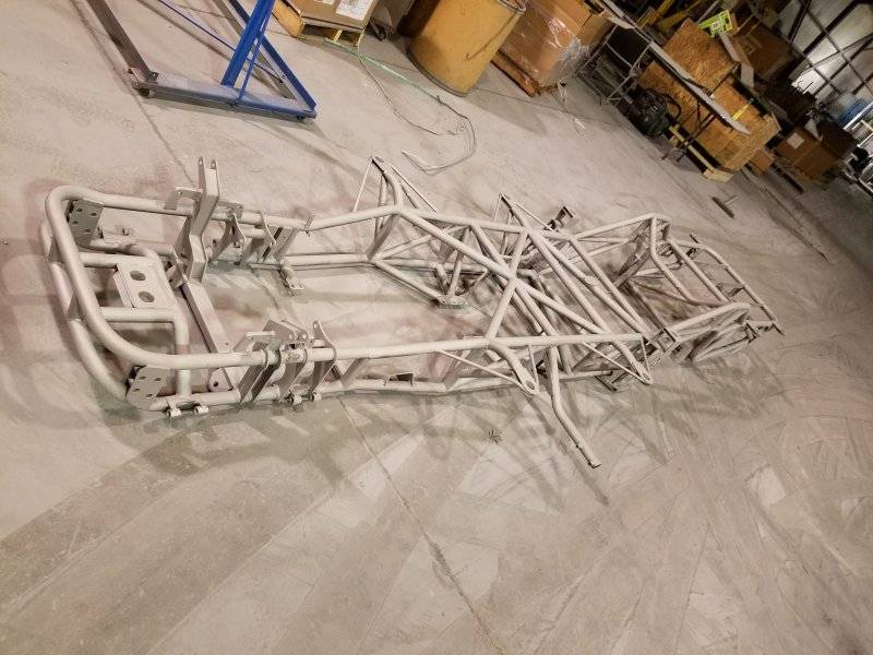

I have a tube chassis that was powder-
coated in Indiana.
During the installation of the truck bed,
the top rear tube was nicked/gouged.
How would such damage be repaired?
(the gouge is not down to bare metal).
Thanks in advance for your time.
Thank you Scott! That means a lot coming from you! I've spied on you from time to time and am familiar with your high standards. Keeping craftsmanship alive is paramount.I have a powder coat company that I use for my automotive equipment, and they do a great job. I would never use them for my car projects. The work you do is amazing
Too late...Oh, bummer on the chip! Accidents happen ... and it's good it didn't expose bare metal, but chipping can be a sign of inadequate prep (i.e., a spot that wasn't blasted or cleaned well afterwards), overcuring or undercuring so keep an eye on it for similar impact issues elsewhere.
Aside from a cost-prohibitive stripping and complete reshoot, you can't really "touch up" powder coating with much success. It DOES make a great base for paint (assuming it was properly prepped and cured) so perhaps some high build primer can be feathered in to fill the gouge recess. I am not and will never claim to be a painter so talk with a qualified one and see if there are better options.
I do know a lot of governing bodies are now discouraging powder on frames (and even some roll cages/bars) based on tech's inability to inspect the welds so I'd at least check with yours before throwing more money at that chassis.
Your story is one of the main reasons I stayed with a 7-foot oven versus a huge one. The bigger the part, the more thorough the quality control has to be ... and I'm much more concerned about craftsmanship than I am about a big pay day.
Please keep me posted on what you do with the repair! I wish I was more help ...
