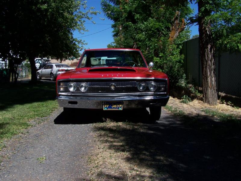

I have a hood scoop on my car no regrets but I have a extra hood if I want to take it off
