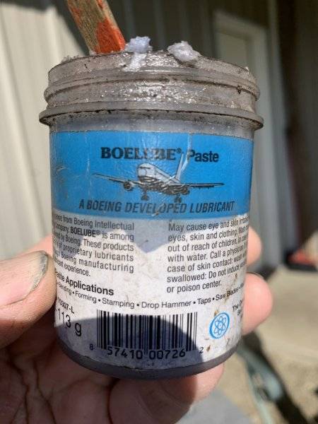

Been meaning to post this but keep getting sidetracked- do any of you guys use this? Boelube paste- been using it for years- I have 20+ year old harbor freight drill bits that are still sharp. Put it on metal cutting bandsaw blades too and be amazed at the difference.
I was introduced to it 37 years ago when I started working in the big hangar in ATL. Best drill lube there is.

Does it have a BMS number somewhere on the label? Just curious.
I guess you have to work at Boeing to know about it! any instructions on the tub?
If you worked on commercial a/c of any type where a lot of structural work was done it was used. Boeing, Lockheed, Douglas, and even Airbus it was used on.

It says "drill bits, reamers, bending, forming, stamping, drop hammer, taps, saw blades, weld shaving, deburring" on the label. I bought a bunch of it for my crew that needed to drill a lot of stainless, they were amazed how well it worked.

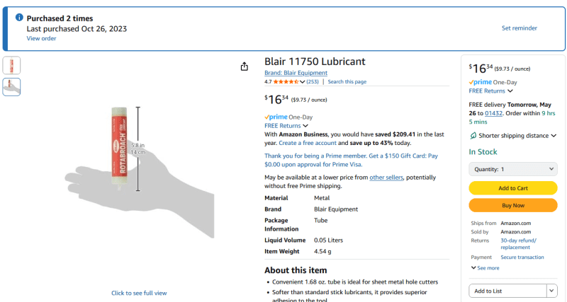

Another cutting lube I use is Blair's lube stick for their Rota-Broach cutters. I need it because I have 5 sets of various sized cutters that I use regularly.
