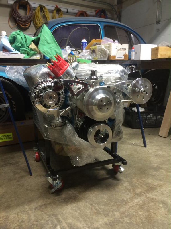

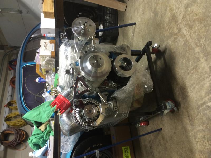

I just finished mocking up my CVF Racing pulleys, PS Pump, and alternator. image.jpg
Sorry. Dunno how to flip.
I can't tell by the pictures. Is that a serpentine drive?
I was curious if you call them to order, what kind of questions should I be ready for, other than just saying big block Mopar?
No, this is the v-belt system. I am not sure how much room I would have lost with the 6 rib belts.
I am not sure what you mean. You will need to use the Mopar style alternator. Also, just need to know what accessories you are running. I didn't speak with CVF directly, I ordered it from my buddy's at The Mustang Shop. I am one of the only Dodge boys there. Great guys!
Sorry I didn't clarify my question better. I knew there were some issues with what power steering pump you have. I ordered a kit from them directly. Not easy to talk to on the phone but went ahead and ordered based on what I read here. The only question was whether you want faster pulleys or slower ones. Looks good on yours.

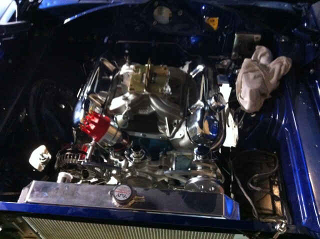

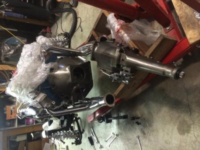

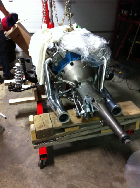

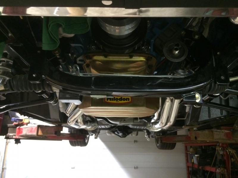

Just wondering what kind of headers those are? The collectors look like my Patriot/Jegs type. Do they clear the angle spark plugs ok on your aluminum heads?
Hi Gary,
I have stealth heads with Doug's D452 headers.
Everything fits great. But, might be because I have the RMS suspension so I have a lot more room. I had to remove the header to install the mini starter. That only took me 20 mins.
