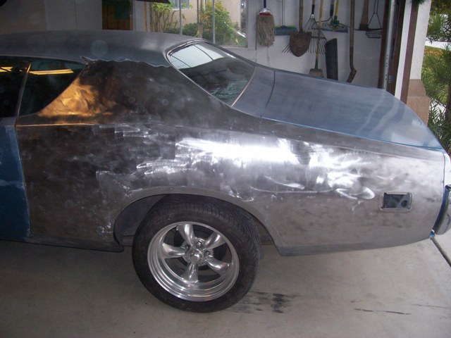

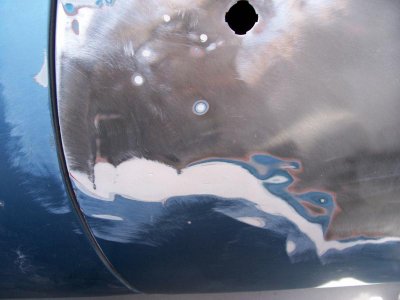

I probably had only a couple coats, but lots of bondo in different spots. I think most of it was from quick and easy and cheap body shop repairs over the years from minor crash damage. Bound ot happen on a 40 year old car. Some places the bondo was an inch thick. Almost like they couldn't figure out when to use a dent puller or how to use one properly, lol. On the left rear quarter it was caked everywhere from making the whole panel match the 1 tiny high spot from a dent puller gone a little bit to far.
I basically did 1 area or panel at a time and rattled can primered that area when done to protect the bare metal. Once I had the whole care done I quickly sanded all the rattle can primer off before delivering to the paint/body shop. All in all, I probably spent about an hour total on each panel, thats not counting beer or bathroom breaks. So maybe 1 panel completed per evening. Here are some pics.

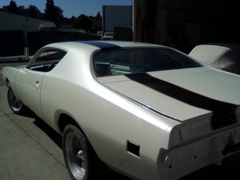

Oh yea 1 other thing. You can't see any of the sanding scuff marks I left in the metal after sanding. Here is a pic of the car after final paint. Its a 3 stage pearl white and it looks just fine.
That looks pretty nice, Rocky. 3 stage...hope you don't have to touch it up later. :) Is that a Cadillac colour?
The colour is from a colour chart my wife picked out from the Sherwin Williams AWX waterborne paint system. She picked out the metalic black stripe and layout as well cuz it's her car. The off center stripe wasn't my idea but it looks better in person and its growing on me. Yes the colour looks similar to what you see on the Escalade's or those pearl white Lexas IS250's you see driving around.
The clear coat is very durable, I wacked it pretty good when the fuel tank slipped out of my hands. It didn't leave a mark. Glad she wasn't there when it happened.
