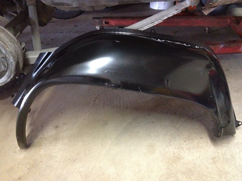

Thanks for the good words, I can only hope to match the work going on in some of these other threads. Maybe in another 20 years. :toothy6:
I have a pile of new metal waiting for me, I just had a new outer wheelhouse arrive on my doorstep. Hopefully some more progress updates this weekend. The rest of the car isn't as bad, the drivers side really took the brunt of Pennsylvania's worst. The floors and frame rails are all very solid, apparently the barrels of undercoating did some good. Hopefully the old girl is done throwing out surprises for the time being.

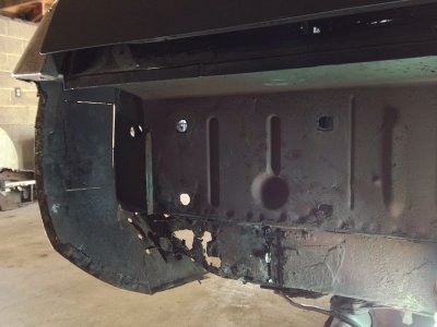

Small progress update, I've been spending some time making room for some new sheetmetal. I cut out the old trunk extension on the driver's side. Looks like I will have a small amount of patching to do on the lip that it welds to, but overall the rest of the metal in this area doesn't look too bad.

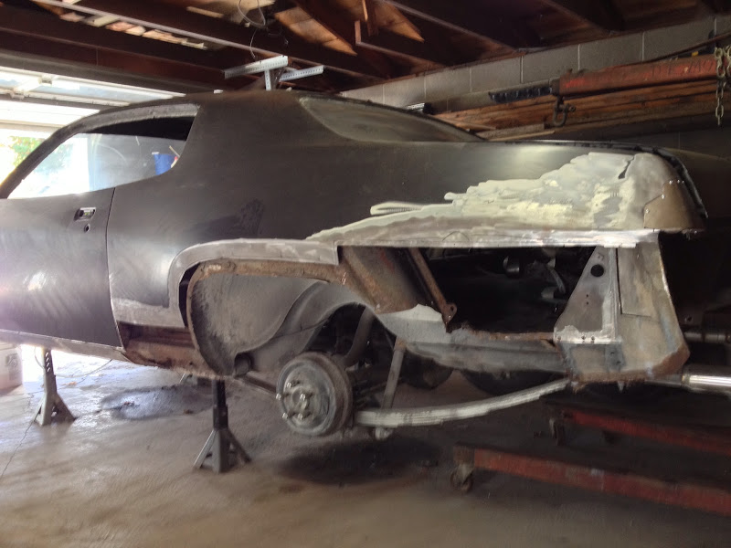

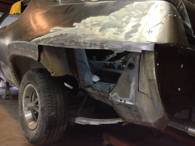

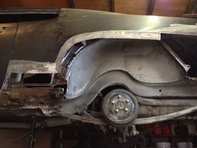

I also tack welded the new wheel lip I am making together so that I could unscrew it from the car, then I started cutting away the old wheel lip to expose the outer wheelhouse. It was at this point that I realized the lip was no longer present, time to order more sheet metal.

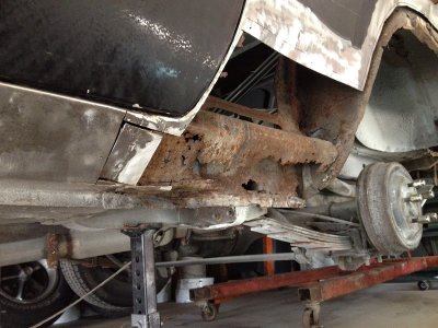

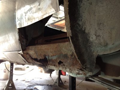

Also at this point I discovered, much as I was expecting to, that my inner rocker is toast. This car has made the decision for me that I will never own another northeastern car again. Thankfully it looks like the inner rocker is going to be a pretty simple piece to make, it's just flat metal with a few bends. I'm sure rear seat passengers are going to feel a little more reassured knowing their seatbelt isn't going to run the risk of detaching from the car in an accident once this is all finished.
There was also a small patch on the back that was hiding this, nothing too serious, I had already ordered the filler piece for the trunk extension expecting to find this.
New Metal! Better make room.
Time to break out the angle grinder again...

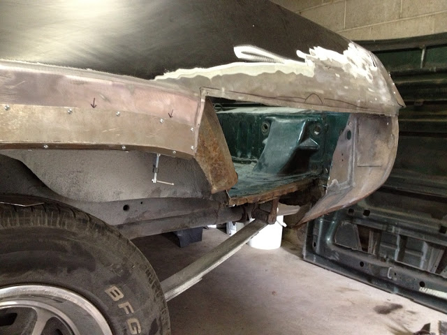

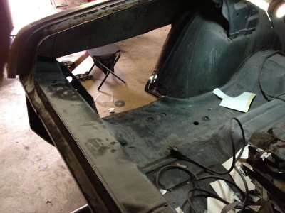

I will need to make a few more patches before I start welding in any new metal, as some of the parts of the inner wheel house that were butted up against the rusty one are a little crunchy, but overall no new surprises.
I'm definitely not used to seeing so much of the car opened up. I'm looking forward to starting to close her back up again. Great news is that I was mocking up all of the parts back on the car, and the parts I made fit the new outer wheelhouse. Next step is making a few little patches so that I can start welding in the new metal.

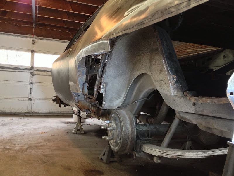

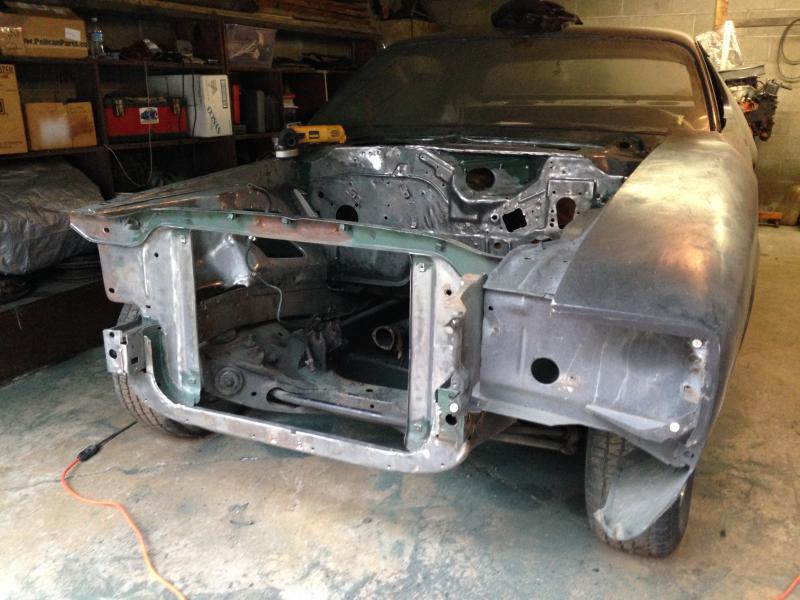

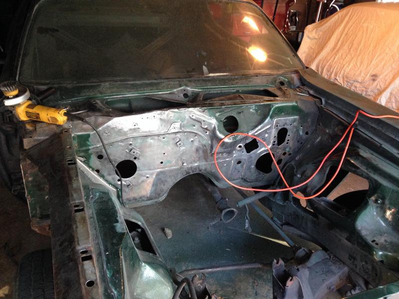

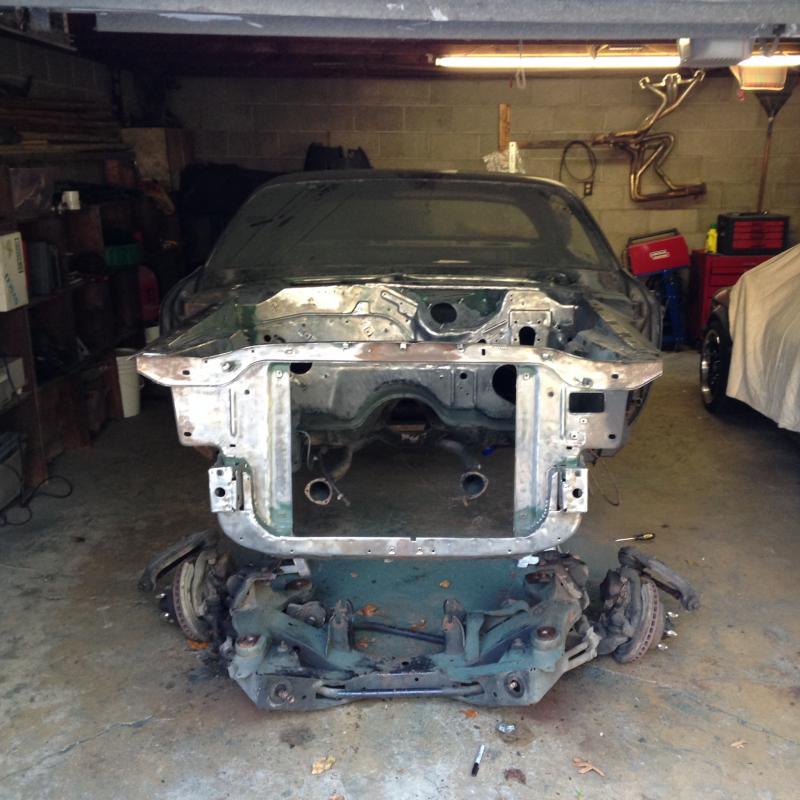

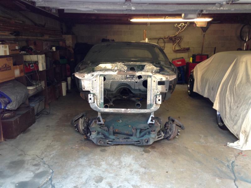

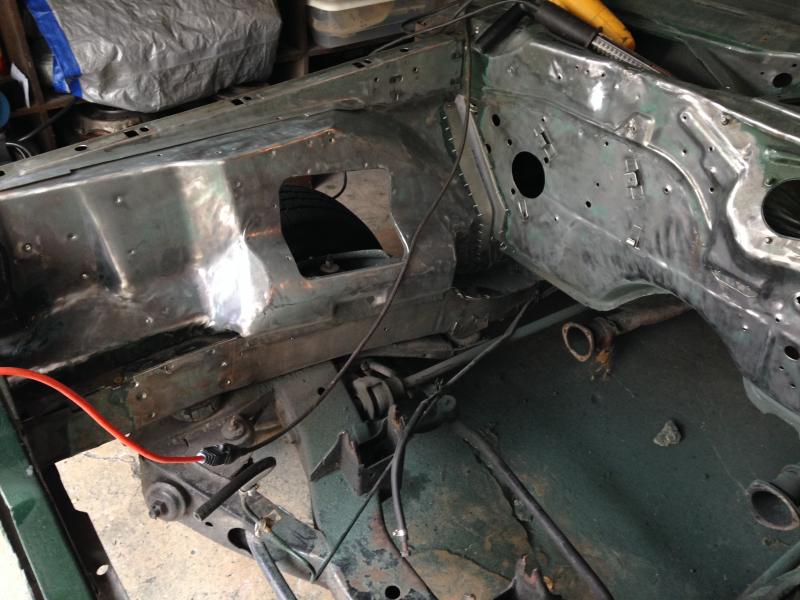

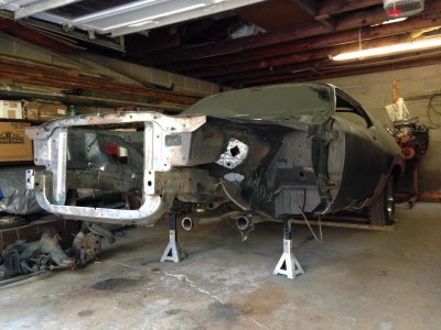

It's been awhile, so I thought it would be a good idea to post an update. Life has been getting in the way, so progress over the summer has been very slow.I started taking the firewall and engine compartment down to bare metal, then things quickly progressed into dropping the subframe to allow a much more detailed job. Thankfully no additional rust has been discovered, and the framerails are clean.photo.jpg
I was very happy not to find additional rust in the firewall
Thankfully all of the bolts holding the old girl together gave up their hold with the help of a little bit of PB Blaster.
I can't wait to get the suspension blown apart and begin restoring individual components, hopefully soon I will get to see the car looking better in fits and starts, not just making everything look worse as I go. :-D
Looks like she's no longer a rolling chassis.

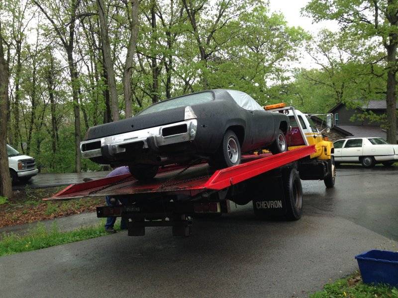

Last year, my dad and I decided to pick up where I left off, and restart the project together now that my dad is retired. This is my last picture of the car in 2014 as it was hauled off to storage in my parent's garage:

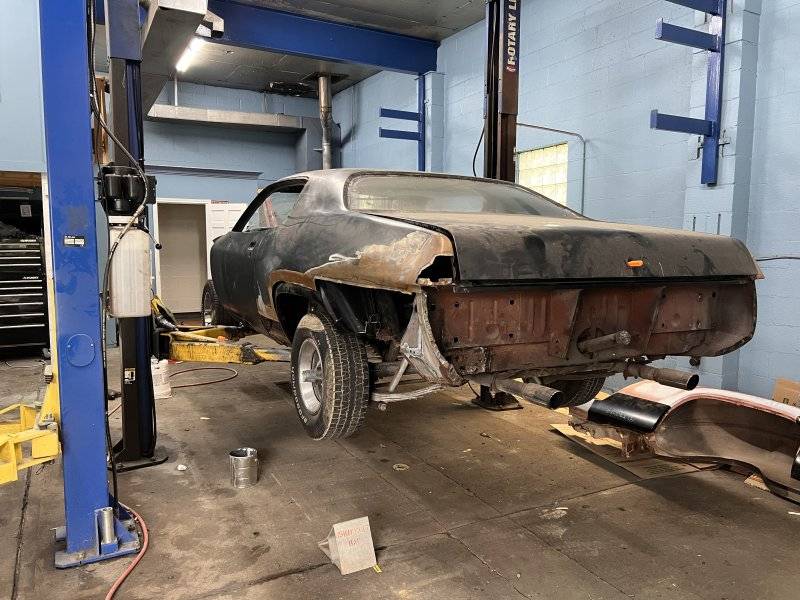

Once I arrived in PA, my dad and I hauled the car out of my parent's garage (under it's own power), threw it on a tow dolly, and moved it a few miles to a bigger shop with lift access.

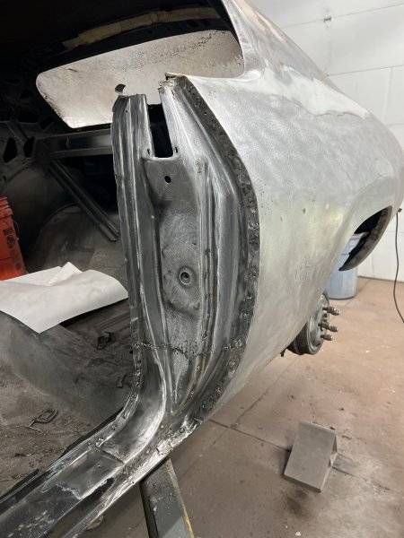

Once we had the car in the shop, the old patches I started over a decade ago came off of the car.
From there, we had to cut a fair bit deeper. The quarter I brought wasn't perfect, but it was solid and had all of the under structure we needed.

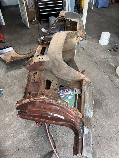

At this point, we are seriously questioning what we've gotten ourselves into. Time to start disassembling the donor quarter and take everything could off of the thing.
Thankfully, all of the structure in the donor quarter was in great shape, so I dug in and drilled out all of the spot welds holding it together. I don't have pictures of everything, but by the time we were done there was pretty much nothing left of the donor quarter. The inner rocker, seatbelt brackets, lower part of the door opening, and big chunks of the support structure around the inner fender all came off the donor panel and found their way into our old Plymouth.

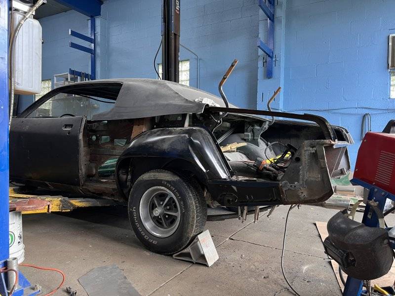

When I left PA at the end of my visit in June of 2024, we had cut all of the rusty metal out of the back of the car, started welding in the under-structure, and had the replacement quarter panel patched (it also had some rust) and mocked up on the car.
What did we get ourselves into.

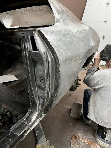

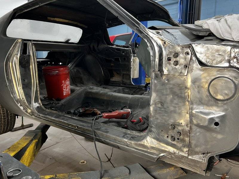

In February of this year, I made a return trip. Kicking the project off with a big push meant my (now retired) dad could putter on weekends, and while I was gone, he started welding the rear quarter panel and all of the associated internal structure into the car. This is what I came back to:
From here, we tag-teamed the car over the next week.
My dad did metalwork, and I handled grunt work and started stripping all of the work areas down to bare metal.
It was.. a lot. By the time I left PA this time, most of the welding was done on the car, and the door jambs and remaining areas in the front end that I hadn't been able to finish in 2013 were down to bare metal.

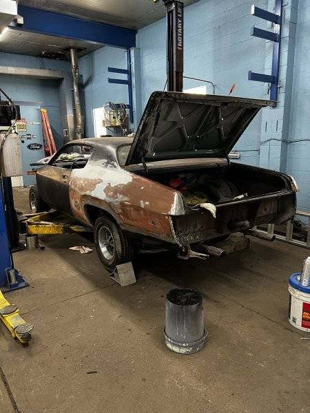

My dad had been doing some more projects while I was back home in AZ, so when I arrived the car looked like this:
The agenda for this trip was to finish up the welding on the car, and start finish bodywork. While he worked on skimming the quarter panel, I worked on stripping the backsides of the doors and doing some more rust repair. First up, some cracks in the passenger side door.

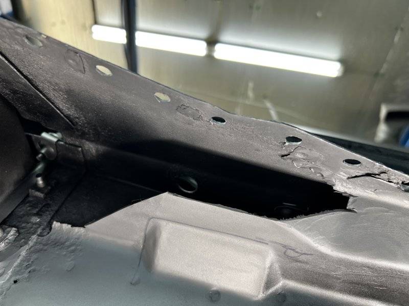

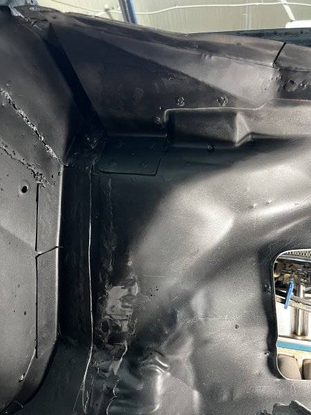

The other big project was the passenger side upper rail. This one wasn't as bad as the driver's side was 10 years ago, but I needed to dig in and make some patches to wrap up the structural welding on the car.
Time to bring out the old CAD (cardboard-aided design) skills and design another patch.
An 18 gauge steel patch was cut and folded:
Then that patch was primed with some weld through primer and drilled for spot welds.
The old rusty metal was cut out of the upper rail:
And the new patch was clamped and screwed into place:

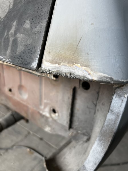

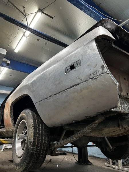

Then I welded it into the car to wrap up the last of the major rust repair.
By this point we were FINALLY done cutting pieces off of the old girl. Only took 13 years to get there.

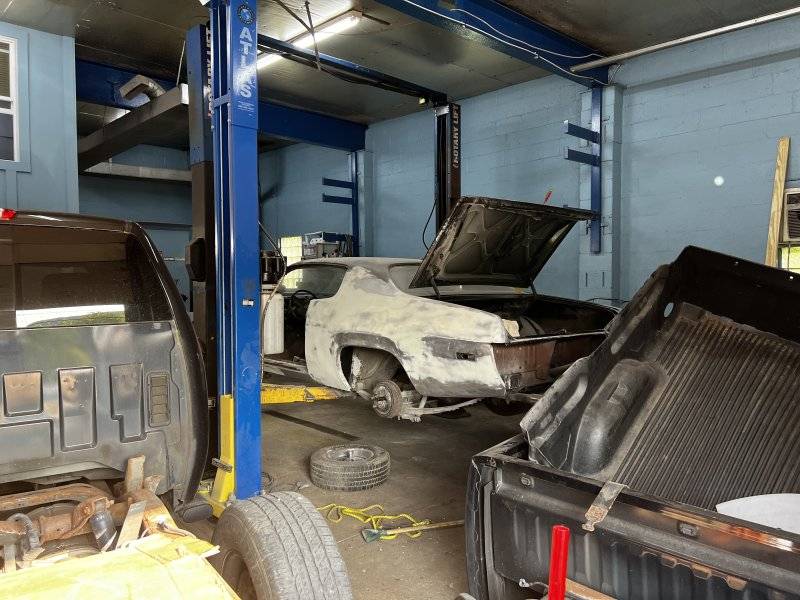

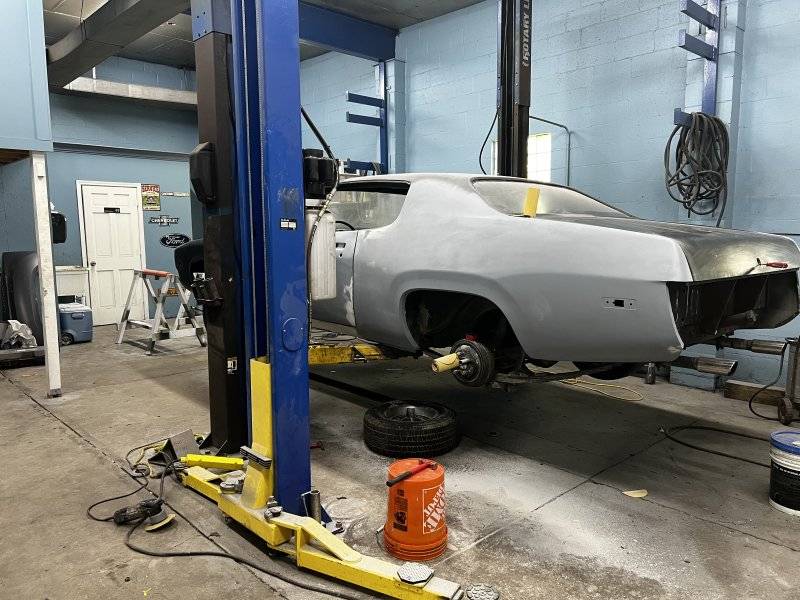

Our last project this month was to mount all of the panels back onto the car, and start getting everything lined up for finish bodywork. Everything will come off again for paint in a few months, but this is where we sit today:
We still have a lot to do, but it feels good. For the first time in my living memory this car is rust free. It has taken 13 years to get to this point, but we are getting there!
