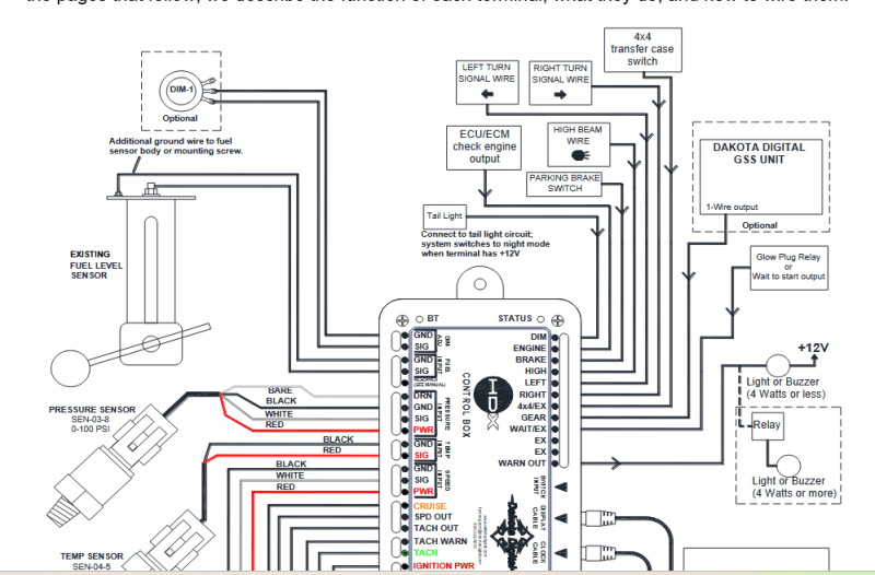

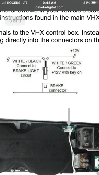

Just wondering if the ‘ Brake ‘ circuit on the control box gets tied to the emergency brake, or gets tied into the brake wire from the proportioning valve?
I was thinking the brake wire on the proportioning valve plugs onto the box to alert theres a pressure loss. But not sure. Thanks
Look at the instructions. It clearly tells you where it goes.
Gonna tap into the black wire from the e brake. Looks like they are all grounds

Here is what they say.
Seems like its already wired in
No. You still have to wire them. It depends on which option you chose. If you use the new ones they are built in to the new cluster. If that is your choice you wire the inputs into the interface box. If you choose option 2 using the factory light locations you wire those direct with the three separate harnesses. Either way you still have to use the cars factory wires and decide which way you want the cluster to show the indicator lights.
