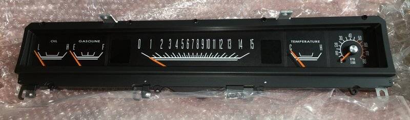

Surprised me when this arrive today! Several weeks earlier than they promised.

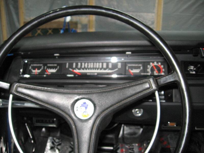

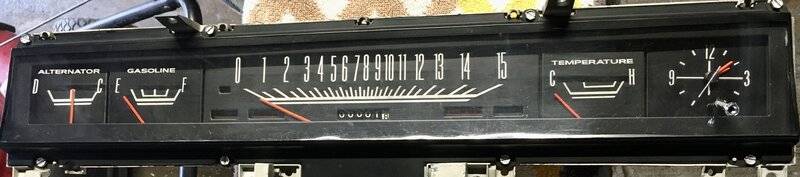

Soon out with the old...
in with the new...
have fun installing :thumbsup: hope its everything you expect it to be.

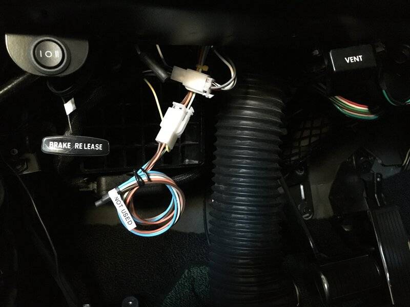

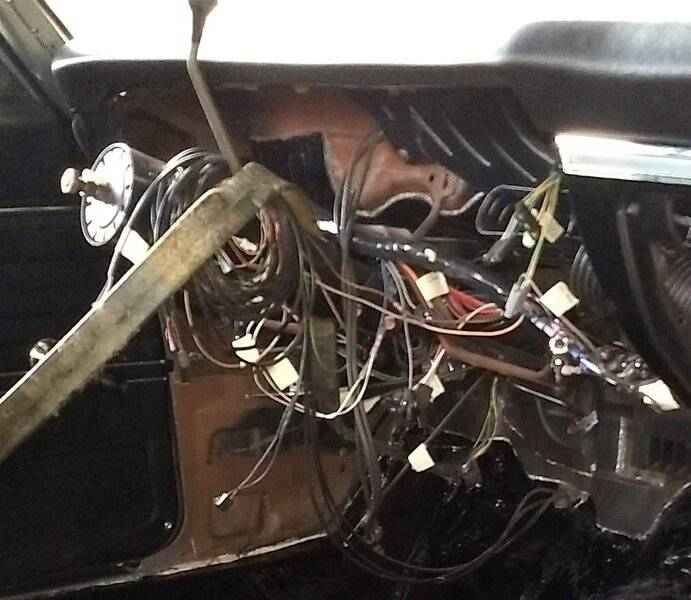

IMO a key to installing the system is picking a good spot for the connection hub, and look at the route(s) each wire will take. I know that's basic, but worth mentioning.

There are quite a few wires and connections to the existing dash harness to make. Take your time and the install will go smoothly. I bought the optional dimmer knob and installed it before I read the manual. There's set-up menu to adjust the brightness of the ked backlight with the headlights on/off.

Planning: Neat, Complete & Reversible -if possible.

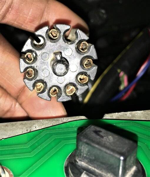

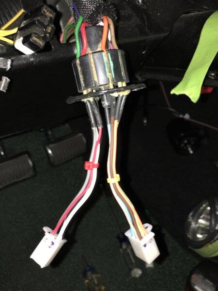

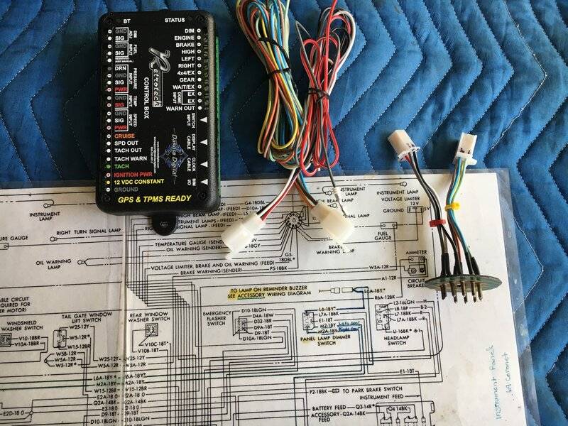

For starters, I made this adaptable harness from an old, not broken, gauge circuit board that I cleaned and soldered wires into so that it can plug into the factory console harness. That way I don't have to cut into it. I Just hope the push-in connection will be good enough.

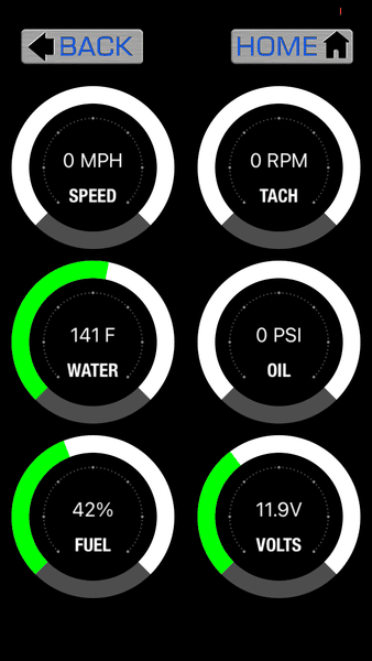

There's an app for that! No... really there is. It's helpful for setup and diagnostics as it can show the ohm values of the installed sensors (coolant, oil, fuel sender). Seems useful right now. Here's a simple screen shot of it after my install & warmup.

Making this plug-in was really convenient and helpful for the install. It took a bit of planning on the front end, but it proved to be handy on the back end because I forgot to make the DIM (dimmer) connection after I installed everything but since I already had the wire from the OEM harness all I had to do was attach it to the control box w/o splicing or removing the gauge!
