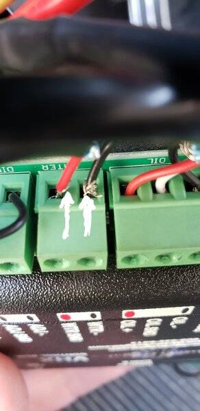

Today I decided to get into it and Dakota Digital tech support was FANTASTIC, although I found the problem myself.
Yesterday and the day we drove the GTO back, I just couldn't believe that it was overheating, and yesterday it was stone cold and the water temperature gauge was pegged on H, with the digital LCD reading either 280° OR - - - flashing dashes. I decided to remove the bracket that holds the control box and modules under the dash and THIS is what I find where the water temperature sensor wires in:
The torque on the wires bundle actually had the 2 wires by the white arrows I drew much closer to each other and those sloppy strands of wire, that absolutely should NOT be like that, were touching each other. I disconnected and retwisted and slightly trimmed the ends, and reconnected them and VOILA!! The water temperature AND fuel gauges both work!

It is good to solder wires before inserting them in slots if possible.
Especially delicate wires because is makes a solid tip to insert and holds up under use and will not leave stray strands.

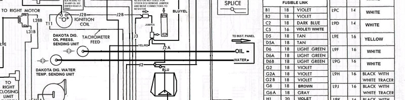

Here are the prints I drew up for a heavily modified 67 Charger (a much more complicated car).
As you can see only two things go to the Dakota system.
I believe these are shielded wires and heaver.
It is best to run the separately some way.
The tach just uses the same feed off the coil.
(I found MS "Paint" to be a good program for drawing prints.)
