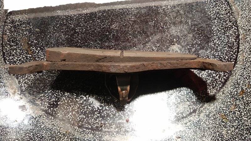

Quick follow-up. Found what the problem was. Turned out it was coming from the passenger rear. The caliper bracket has the stainless covers that the backing plate guides ride on. There was a bunch of rusty debris that got between the cover and the bracket, distorting the cover and hindering the ability for the backing plate to slide freely, causing the inner pad to wear unevenly. Outer pad was almost like new. Removed all debris, straightened out the cover, replaced pads and works like it should again. Thanks for all the help and advice.
