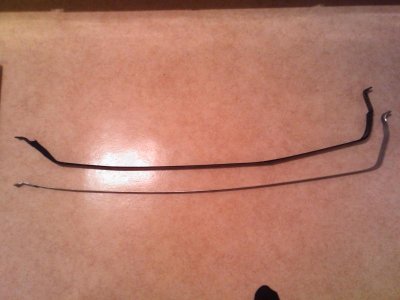

Hello!
Bought a new fuel tank, I used the old straps to hold it, couldnt get it in place,
Its like the tank wont go high enought for the straps to fully wrap around it, or the straps are to short i dont know..
Really frustrating, spend 4hours pushing and pulling stil not getting it up there.
Anyone had these kinds of problems with new tanks?
Car is a 70 roadrunner, ECS fuel tank.
/Linus

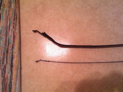

I went and bought new tank straps today, instead of dealing with the old ones,,
and then I saw that the new ones were´t bent, I guess thats why the old ones didnt fit, U need to bend the after the shape of the tank..
Is there anyone who has done this and know a good way to go about it??
/Linus

i replaced the tanks on a 71 charger and 67 coronet and both cars i had to bend the dog ears up closer to tank so it would raise up nice and tight to car and old straps worked fine. the dog ears i'm talking about are the bends right at the shocks that are on the tanks, the new tanks were not bent up as high as the old tanks. just my 2 cents. tim

My original plan was to use the old straps, but after 3-4 hours of struggling I gave up! The "bends" on the old straps doesnt match with the new tank, The result are that the straps doesnt embrace the tank completely, They are slack in the middle, thus to short in the ends!
With new straps I hope to be able to bend them to get a perfect fit!
Do you have any good advise on how to do that? Messure etc..
/Linus

not quite, I haven´t tried the new straps on yet, as U can see on the pictures, they need to be bent to fit around the new tank, thats what I was asking about, anyone have had experience doing that?
I couldnt compare the old/new tank since I throw away the old one...:(
would have been good though..Original stuff always works best uhu..
Just bend them over a tube with your hands, its not that hard to do, wish I was closer to you, I have been working with sheetmetal for 30 years.
Yeah that would have been great! Thanks for the advise!
How do you messure out where to bend them?
I replaced the tank on my SSP/RRC last year. The straps got straightened out a little when I removed the old tank. But they were very easy to mold back to the new tank. The metal was fairly soft. A little persuasion from a 3lb rock (sledgehammer head) had them fitting perfectly. If I remember correctly, I left the "T" portion attached to the body and just rolled the straps up to the little J-bolts. I held the tank on my knees/shins while I manipulated the straps into place. Just have to make sure the tank is in the proper location. I even had to install it twice because I forgot to put the pad between the tank and the trunk floor on. Not sure about your car, but my tank had ridges molded in the top that lined up with ridges on the trunk floor. I can see where if you had the ridges high point to high point that the straps would be a bear to install. If you slide the tank a little left or right you can feel it slide into place.

ok that is actually a big help! To start in the back with the "t-side" work my way towards the front!
my tank has molded ridges, ill make sure they line up!
good thing u mentioned the pad, have to get that!
