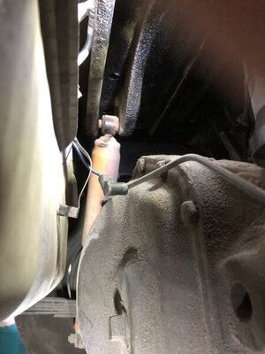

Anyone have pictures/measurements of the clearance between a Dana axle and the fuel tank on a 66-67 B body Mopar? Also wondering if there were different axle covers used over the years, maybe one that doesn't/didn't stick out as far to allow more clearance?
I was shocked how full it is under the car with a Dana 60. There is one cover only.

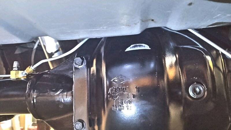

This is what I have on my 67 Charger, Aeromotive Stealth fuel tank, Strange 60 axle.......
Wow. Thats close.
Mine has a dana in it and doesnt rub that i know of.
Maybe i need to take a better look under there

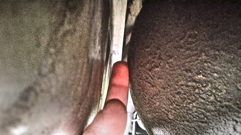

Wow, two fingers! Here is a picture of my 66 Charger with an 8 3/4" axle, only room for one of my fingers.
The one common thing between my Chargers is they both have Aeromotive fuel tanks with submerged fuel pumps, wondering if the protrusion on top of the tanks for the pumps doesn't allow the tank to nestle in as close to the spare tire well?
Plymouth vs Dodge... and that extra inch of wheel base.. or at least I assume '66 is the same as 68/69/70's
Ahhh, the wheelbase difference, I hadn't considered that.

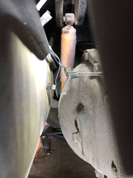

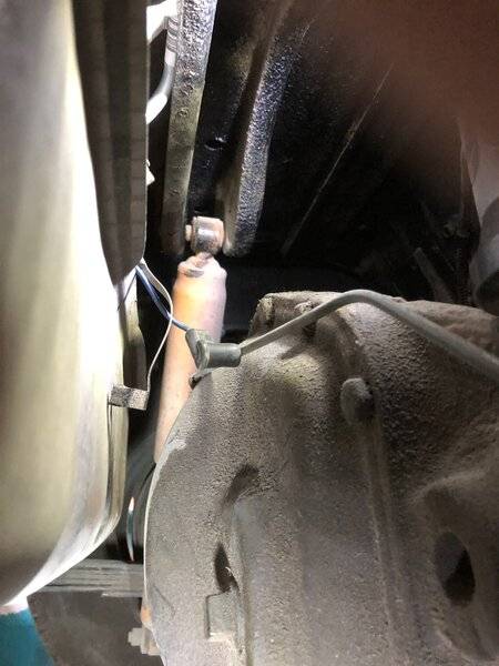

Gee! Crawled under and got these poor quality pictures. 67 Charger. I have about 3/4 inch clearance.
The original factory springs were so badly sagged, missing Dana snubber, the body would come down and put a slight dent in the brake line.
I cannot see how the one inch wheelbase would have any bearing on the gas tank positioning. Where does the 1 inch come into play? I don’t know.
It doesn't move the gas tank Ian... it moves the axle an inch more forward of the tank on a Plymouth. As I noted my two fingers are 1.75" less that inch further back axle in your Dodge = 3/4" !
