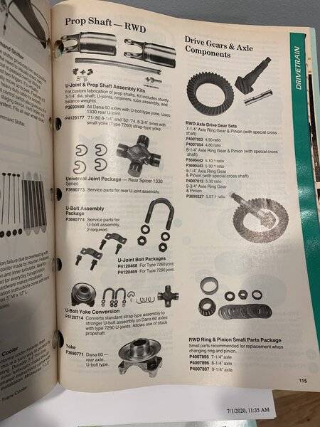

It looks like you have this u-bolt yoke conversion in your car (86 Direct Connection catalog P4120714 it uses a combo u joint I think 7290/1330) I had to put that in my car back in the 80’s because the stock yoke was discontinued by Chrysler.
