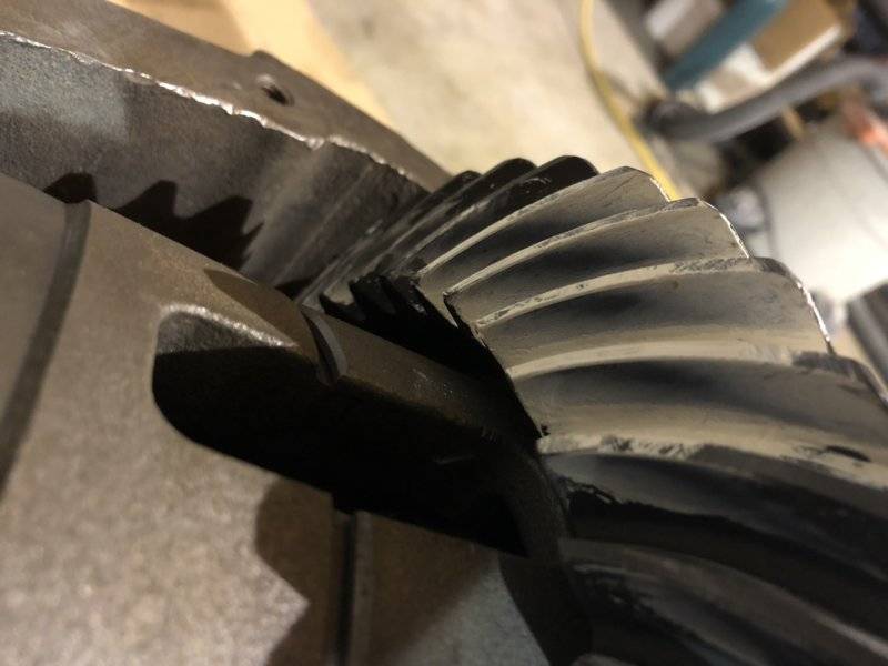

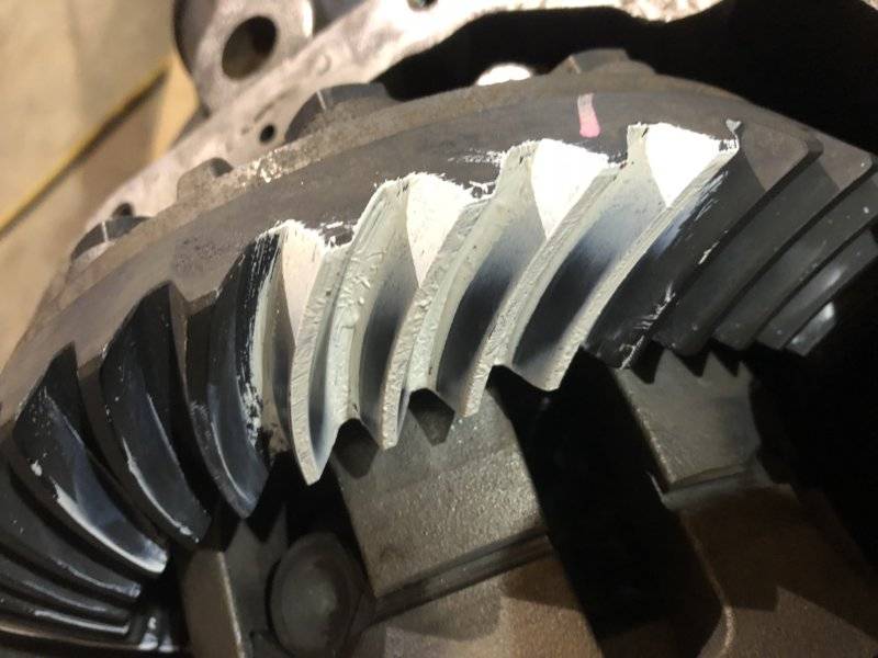

I’m putting a Dana together for my coronet. It’s a virgin setup as far as shims go. As in, its not just a gear swap with existing parts.
I started with .045” on the pinion depth. This is the pattern I achieved with a .010 backlash.
I thought it was too close to the ring so I pulled it apart and set it up with .035”
54E87C7F-E6D9-4394-BE89-57E4342350EE.jpeg 6445BAA9-2610-47BC-948A-CB8C02B41F54.jpeg

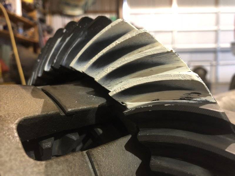

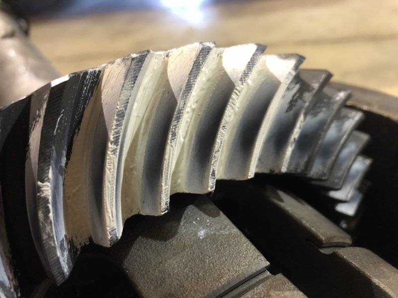

Here’s the pattern with the .035 pinion shims. It looks like it’s a tad too far now.
AA050B5F-67B1-4ABD-9A6B-97A3EB9CBC59.jpeg 67071822-E0FD-4FB2-B3F8-FD695627EB0E.jpeg
2nd pattern is pretty close. It looks like the pinion shim could go back a touch thicker. .037?

Your first is deep but not too deep. On the second I would go to .007” BL and see if it goes towards the valley. Split the difference and see what you get like @dvw said.
