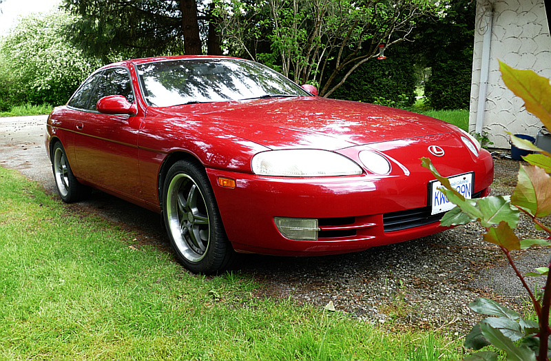

As a comparison, I just took this picture of my car after reading your post; it's a 1995 and you're looking at the original factory paint. There are some problems - it's old and some parts of the clear coating are starting to bubble. But it hasn't faded, and it is always parked outside because I don't have any choice. And although I waxed it a lot when I first got it (back in 2006) I've been negligent for the past few years.
