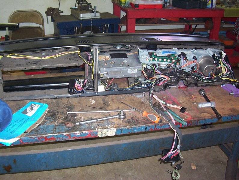

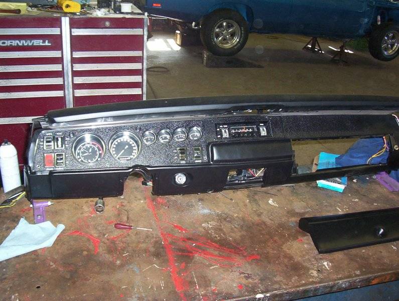

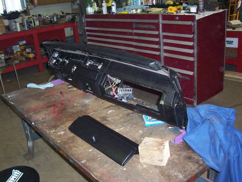

I had a couple scrap pieces of steel and mounted mine to a work bench. On a short stool I could work on either side. Nice and comfortable and tools right where you need them. I also powered the dash up and did a function test.

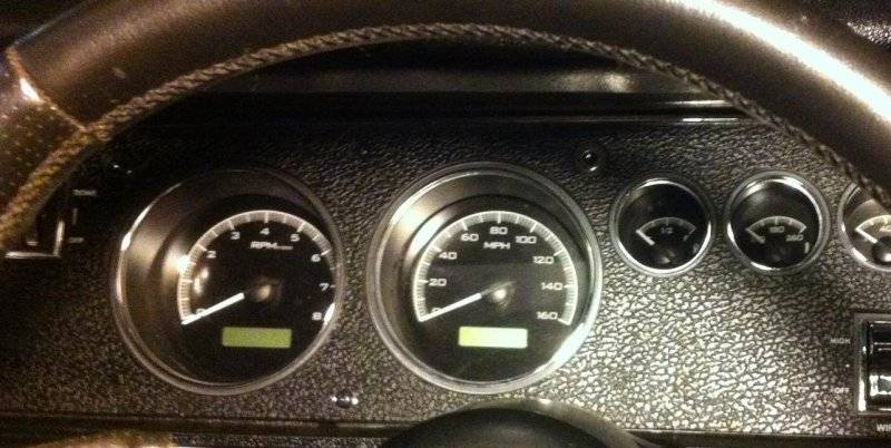

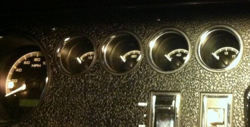

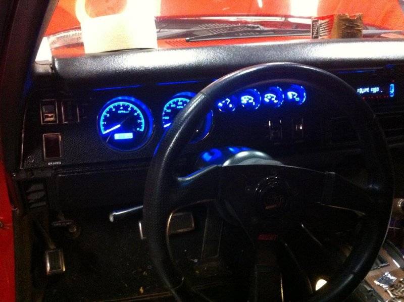

Yes. There were some changes made to accommodate the new cluster. The feeds to the ammeter were cut and removed. The oil pressure and water temp wires were removed and the speedometer cable removed. I did the MAD electrical upgrade with a few small twists. The feeds to the lights are orange wires. Those were disconnected and taped. Overall, most of the original harness was in excellent shape and reused. I disconnected the "key in ignition" buzzer.
I did switch from the stock fuse panel to one from a later model with more terminals.
I later added an auxiliary fuse panel for the other accessories.

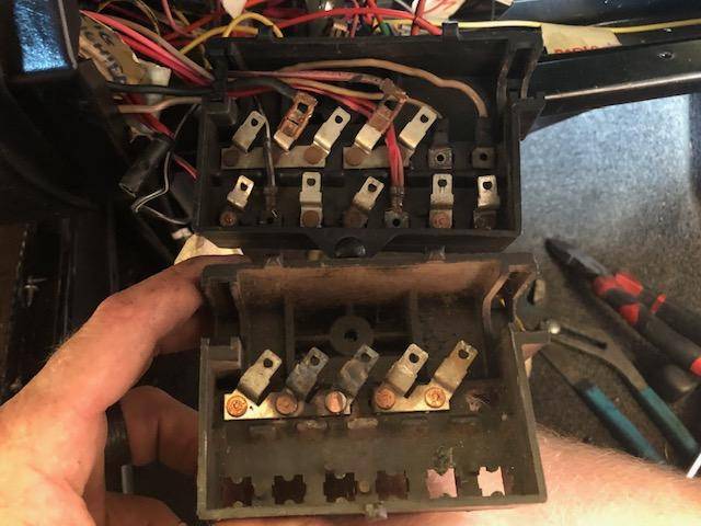

I had to replace my fusebox because mine had too much surface rust, and the only thing that
I didn't like about the re-pop was that the male connector spades swiveled. The stock setup
is rigid. I think that might be a spot for corrosion and high resistance later?
