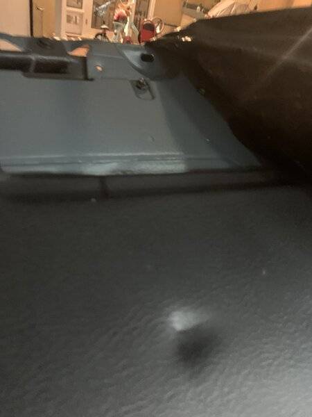

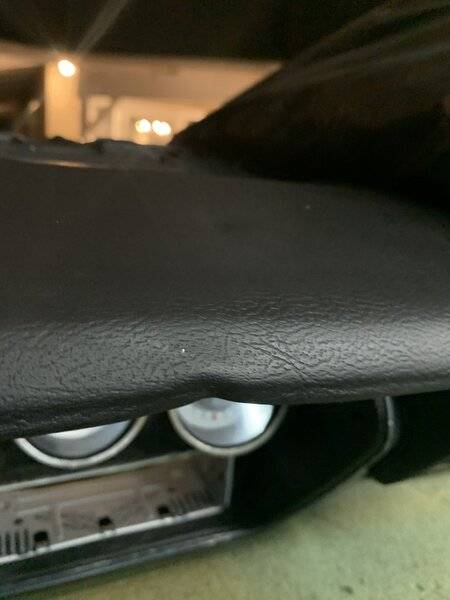

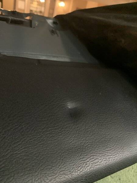

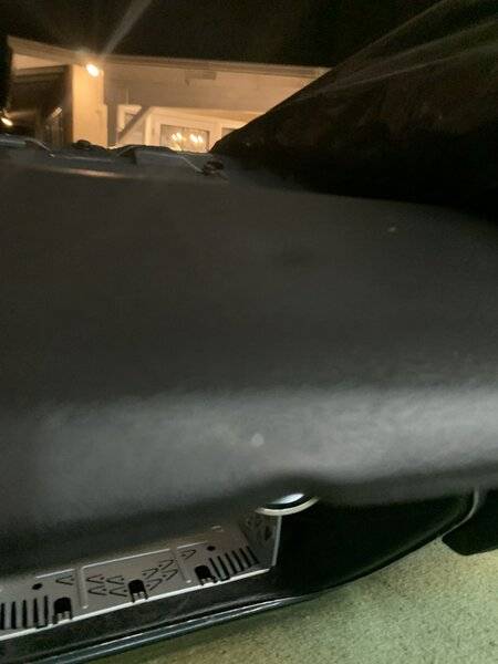

Stupid me, I restored my dash and put it safely in the garage, I thought! Something rested against it, and put a good indent in the dash pad. Two places. Any ideas how to fix?
I’m going to see if the heat here in California, minus the smoke helped bring the dents out.
thanks!
A1AF181C-BA0A-47BF-B8E7-B13038272C6B.jpeg 8C8751D8-BCD1-4BC9-978B-6EF89B15AFFE.jpeg 73A4CB7D-31A8-4235-A68E-675D0BAA9D08.jpeg 657A53F5-626E-498E-B1AA-76C758C25004.jpeg

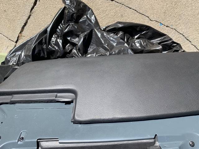

Thanks all! I also watched a video that showed a heat gun or blow dryer can bring it back up.
Yes a heat gun will work but you need to watch heat you can ruin it also take your time use your hand close by and watch for the oils in the material you see that your too hot and close you can also loose your grain in the material
Sometime you can lay a wet paper towel on the indented area, use a heat gun on low temperature and it will draw the dent out. JUST BE CAREFUL
