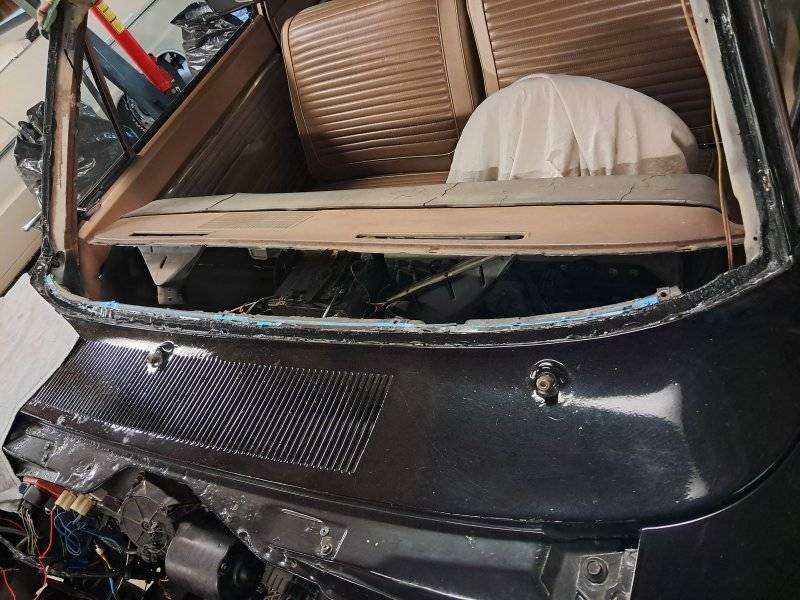

OK, I have to remove the windshield on my 1966 Coronet 2-Door Sedan. I also want to replace the dash pad. I have a new dash pad on order from Classic Industries.
Since I will have the windshield out, is it easier to replace the dash pad with the dash shell out of the car? Or should I leave the dash shell installed, pull the front seat, gauge cluster, and glove box and do the repair from below?

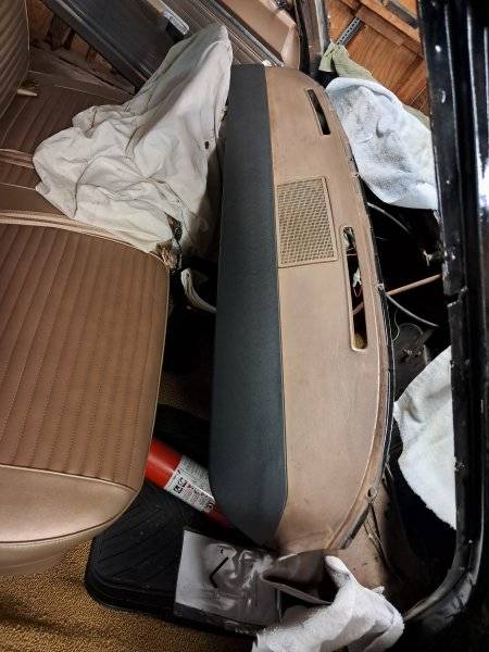

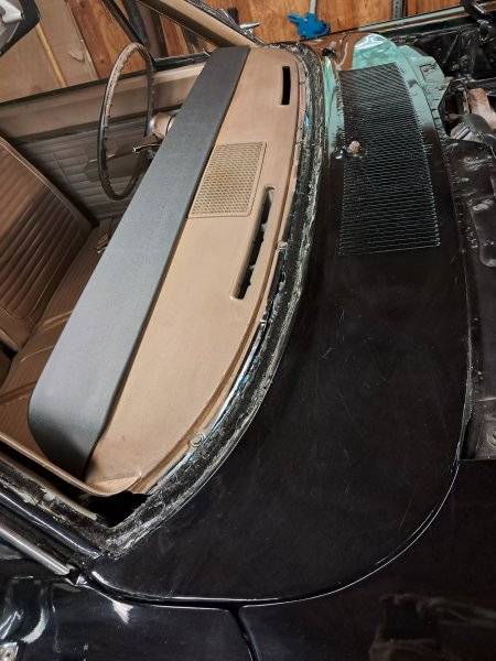

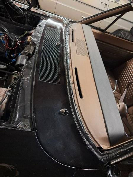

The windshield is out, so just remove the bolts at the lower windshield dash attachment points and loosen the bolts at the kick panels, then just tilt the dash toward the interior. It will rest on the column. The pal nuts can then easily be removed.

I'm in the over 60 club. Flexibility is lacking for me. With this cold weather, flexibility is zero. When it warms a little, I'll probably rock the dash shell toward the steering column, reach through at the front window, and remove the speed nuts.

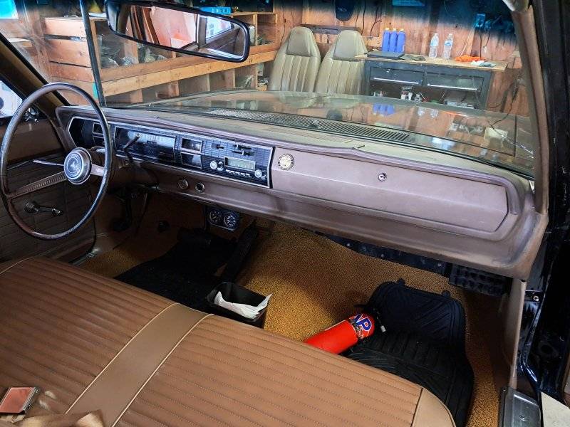

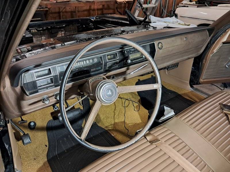

If your dash pad is the same as 66 Satellite don't think you need to remove windshield unless you have A/C. Changed mine. Remove front seat or seats, makes it a lay down job,4 or 8 bolts.

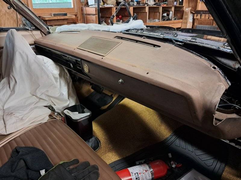

Installed: column on seat, dash resting on column.

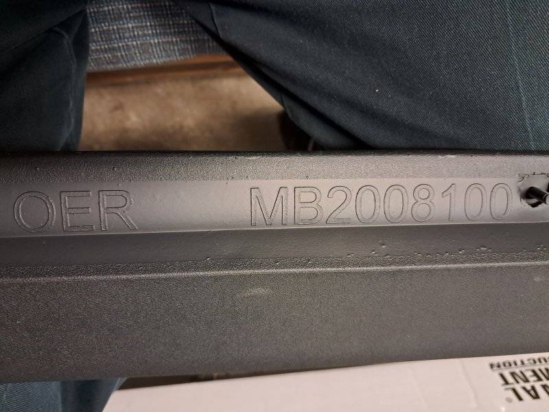

OER makes good quality pad. Classic Industries rocks! $457 with ship after I got an FBBO discount.

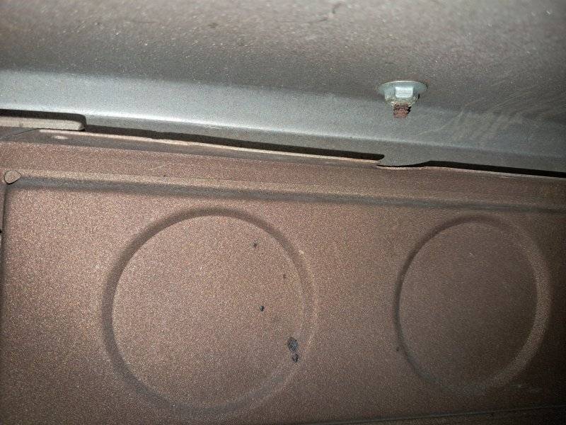

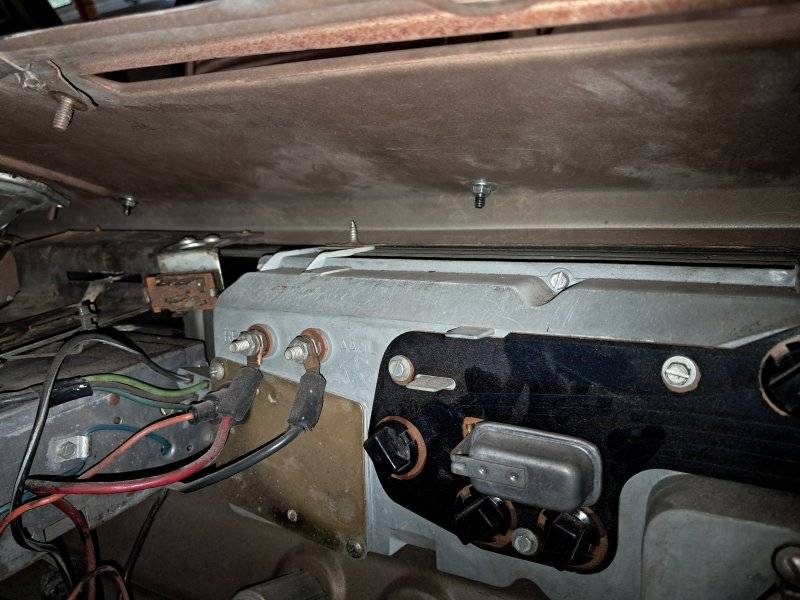

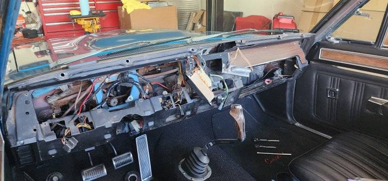

Doing it that way is easier, I was not removing the windshield, so I had to pull my dash apart.
