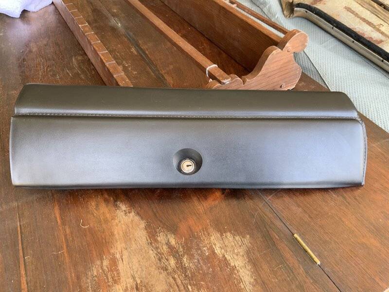

My glove box door is slightly pulling away from the frame. I’m sure someone has repaired these. How and with what type of glue and technique. Thank u

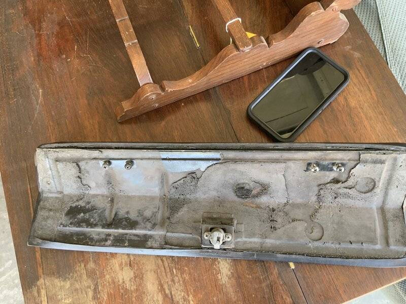

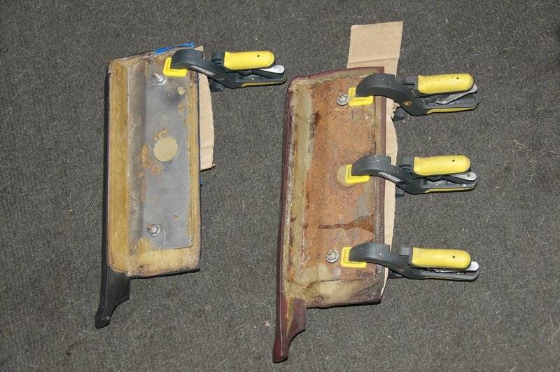

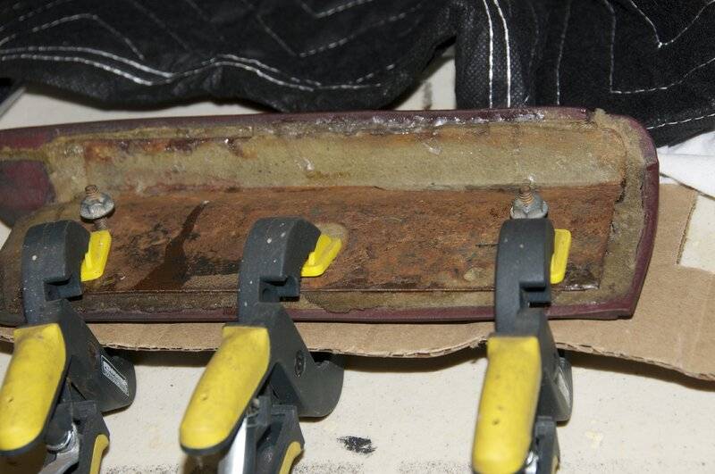

I've done this not even that long ago. I was told by a professional shop that these can't be repaired...they're STUPID. I fixed these and one is in the car and has not had any problems for 3yrs. I glued it with Permatex Body Shop Heavey Duty Headliner & Carpet Adhesive. How you clamp it is important because you don't want to squish your foam. See photos:
I have fixed a couple with a good contact cement, clamping them like QOTHL, but with paint stir sticks instead of cardboard to even out the load.
Yes i was thinking of some aluminum 1by 1
