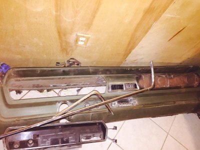

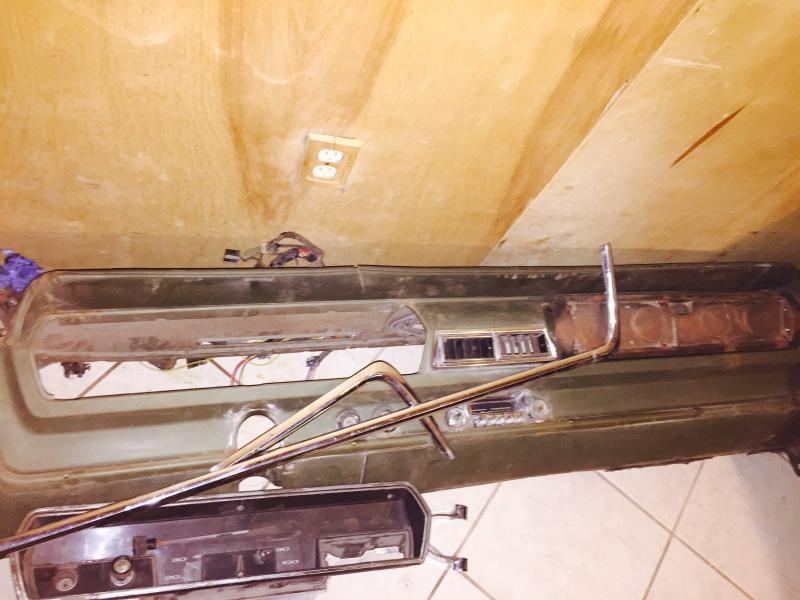

I wanted to put up a quick before picture from the other night and show how the process is going. Still need to remove the stereo and lighter and ignition, which I have no idea on how to.
The bass, treible and fader controls behind tuner and volume knobs will also pull off of radios shafts. Will try to look at wiper knob tomorrow.

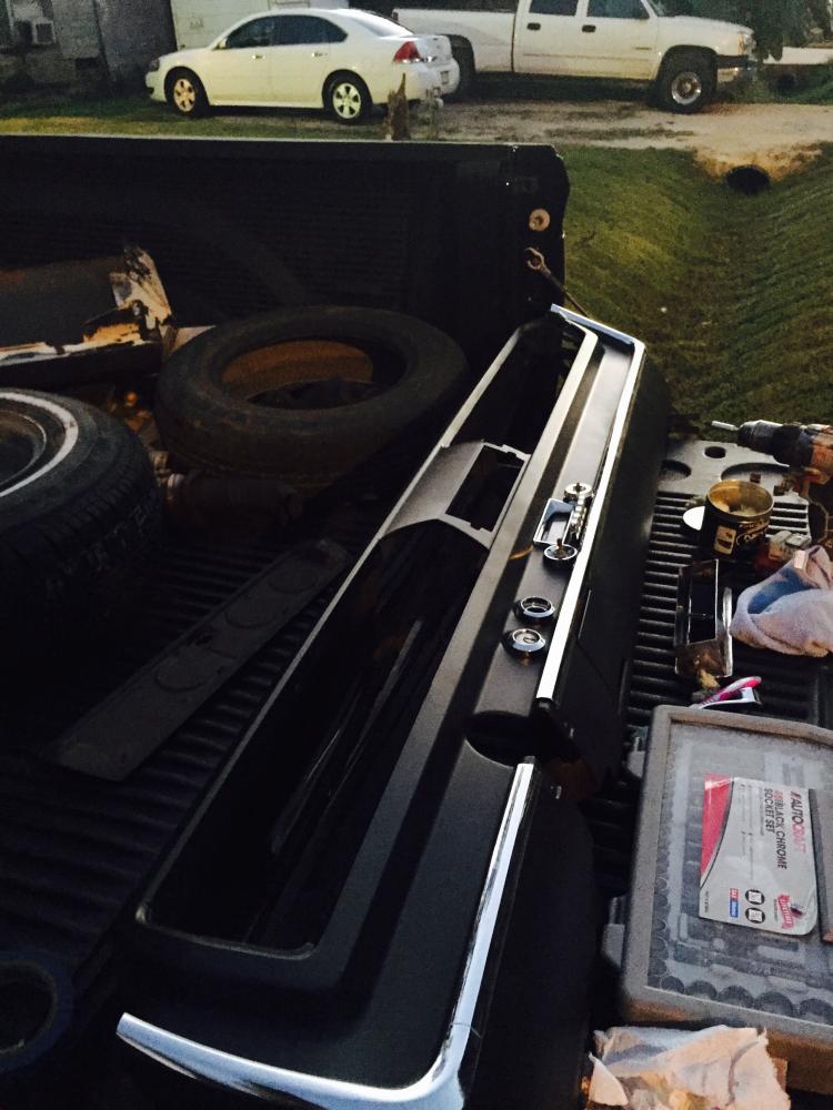

This is how's it coming, still not done. Never did remove ignition switch. But as soon as I'm able to, I'll be sanding again and repaint. What yall think? image.jpg
Can not locate my cluster but pretty cure wiper switch knob pulls off. Ignition switch can be removed using two flat blade screw drivers will have to fit in slot in outer ring notch one each side and a lever between the two turn counter clockwise to remove. You should be able to turn it by hand once broke loose. There is a special socket for this but have never seen it.

This is how's it coming, still not done. Never did remove ignition switch. But as soon as I'm able to, I'll be sanding again and repaint. What yall think? View attachment 218108
Just did it and it worked. Finally, after I painted it lol. Going to repaint anyways. Also was able to pull off the wiper knob. I was scared I'd Brake something, that's why I never tried pulling too hard. But did this time and it came off. Now I can take apart cluster and clean and paint.
