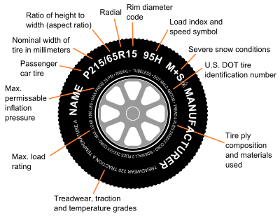

try this
Many tires have the dot number on both sides of the tire, but only one side will have the date digits added to it. Also, tires from the 90’s typically has a sideways triangle with the date digits.
