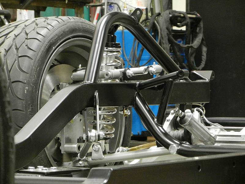

I personally bought the Magnum Force transformer setup same as Kahn and it is plenty beefy. A huge driving factor is whether you want to delete the torsion bars or not. For me the T Bars were in the way of a T56 crossmember so it just made sense. A lot of people will tell you the Frame Rails and shock towers aren't meant to support the weight of the car so coilovers only are a bad idea... This is a reason I'm going one step further than most and doing new frame rails from heavier stock with mandrel bent shock towers & factory pickup locations (kind of like Schwartz performace) Truth be told I'd rather have my buddy just build my front end now and with I hadn't bought the Magnum Force (not because it's not a good system but because we are enjoying making my car the testing ground for my friends chassis shop)
There are still even more setups out there Martz, etc... for my money I would either go Magnum Force or RMS
In this pic you can kind of see what I am aiming for with the frame rails
