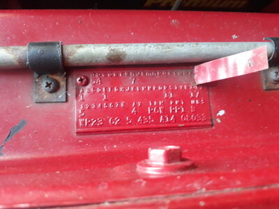

decode a 67 fender tag for me , please

Just wanting to verify some things
And I cant find my GG books
Nice car, per the tag.
67 Coronet 500 383 4bbl automatic, 26 " radiator, bucket seats console, red with white and black interior. Fender mounted turn signal indicators, A/C, and AM radio. 3.23 open rear gears. There are some codes I cannot remember off the top of my head. Build date October 14th 1966.
Yup. Gives decent results. Not perfect. Misses some, but it also hasn't been updated in a long time.
CAR: Dodge Coronet 500 2 Door Hardtop
ENGINE: 383cid 4-bbl HP V8
TRANSMISSION: 3-Speed Automatic
TIRES: 7.75 x 14 WSW
MODEL YEAR: 1967
BUILD DATE: October 14.
AXLE: 3.23 Rear Axle Ratio
INTERIOR: Premium Trim Grade, Vinyl Bucket Seats. White on Black Interior.
PAINT: Bright Red (Dodge, Plymouth), Scorch Red (Chrysler), Flame (Imperial).
OTHER: Black (Dodge, Plymouth), Formal Black (Chrysler, Imperial) Upper Door Frame Color.
MOLDINGS:
15: Unknown Option
ABC OPTIONS:
A1: 26in Radiator
E1: Cleaner Air Package
R1: AM Radio
S1: Air Conditioning
X1: Tinted Glass (all)
Y7: White Vinyl Top
abc OPTIONS:
a5: Center Front Seat
b4: Bucket Seats
h7: Fender or Hood Mounted Turn Signal Indicators

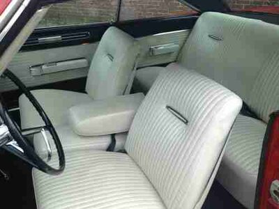

I couldn't distinguish between a 5 and a 6 under the a on the top left of tag 5=buddy seat 6=console. Thanks
Thanks all, It has the buddy seat. which is a plus to me over the console .
E1 ....any chance its a CA car ??????
Which would be wild. I bought it in CA. ,,,that guy bought it from a dealer in Rhode Island, in 2013
Dealer guy bought it in Mississippi . When is unknown
No idea of any of location prior to there

Yes, it's a good chance it was originally destined for CA. E1 is for the "CAP" clean air, closed ventilation system.

CAP stand for, "Clean Air Package". It eliminated the downdraft tube in favor of a closed ventilation system. I believe it it was only on CA cars in '67 and became standard in all States in '68.
