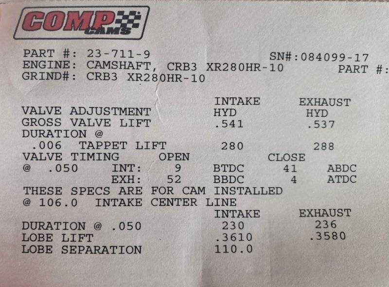

Geoff 2
It is a 505, not a 440. So I would leave it at 108. If it was a 440, or smaller, 106. Bear in mind that according to Crane cams, the cam has to be adv/ret a minimum of 4* for the butt-meter to feel the difference. Unless changed, all Comp FT shelf grinds have 4* of adv ground into them.
